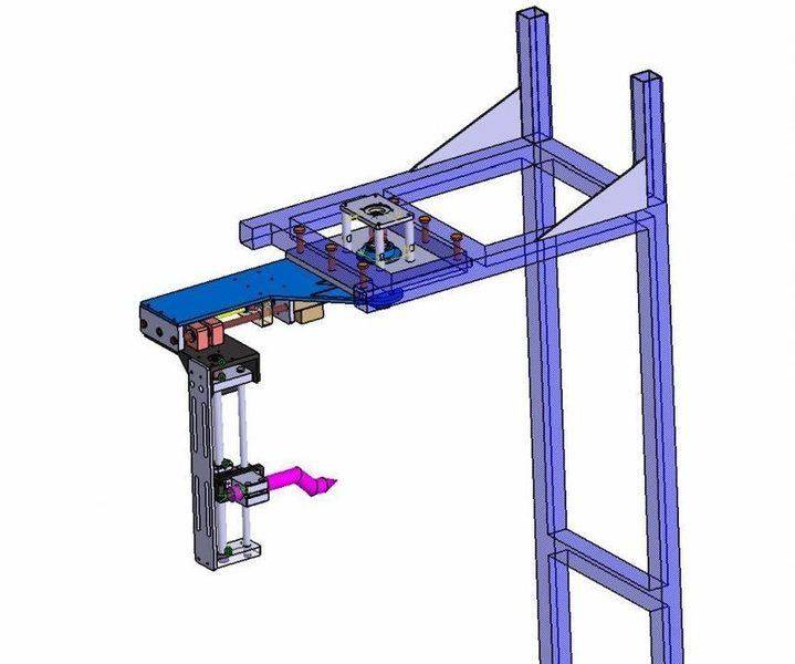

Dear Friends,
I have designed a robotic arm driven by servo motor via a planetary gear box.I have used taper roller bearing & deep groove bearing to hold the driven shaft.The distance between two bearings is 10 mm .We I turn ON the motor, the motion of arm is jerky.Also, I've used lamina coupling to couple the drive shaft.
The rpm of rotation is very very slow.Some say this may be due to unbalanced load or may be due to less distance between two bearings & improper pre-loading of bearings.
3D CAD rendering of a robotic arm mounted on a tall frame, with a blue plate supporting a motor and gearbox assembly and a linear slide with a magenta arrow marking motion.
I've also fine tuned the motor.
Please can anyone help me to resolve this problem
