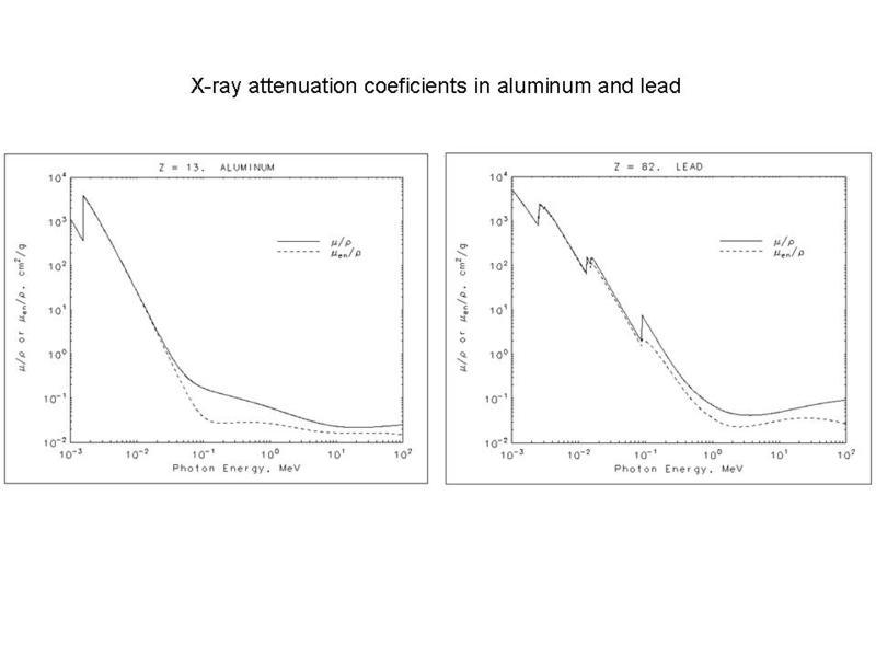

Here are thumbnail plots comparing the x-ray attenuation coefficients μ of aluminum and lead, plotted against x-ray energy. The attenuation is of the form e-μx, where x is the thickness in grams per cm2. X-rays are attenuated entirely by the electrons in the material, not the nuclei. Aluminum has more electrons per gram than lead (why?). Yet the x-ray attenuation coefficient in lead is nearly ten times larger than in aluminum between 10 and 100 KeV. Why?
Bob S
Ref: http://physics.nist.gov/PhysRefData/XrayMassCoef/tab3.html

The effectiveness of x-ray (photon) shielding can be divided into three regions; below ~200 KeV, 0.5 to ~2 MeV, and above ~2 MeV.
Below ~200 KeV (all-x-ray machines)
The shielding mechanism below ~200 KeV is the deep-core photoejection (photoelectron) total absorption of incident x-rays, very dependent on the binding energy of inner atomic electrons in the shielding material. The K-edge, L-edge, and M-edge peaks in the lead attenuation coefficient (shown in the post #3 thumbnail above) represent the binding energies of K, L, and M-shell electrons. Very roughly, the K-shell binding energy is ~13.6(Z-1)2 eV, where Z is the atomic number of the material, and 13.6 eV is the binding energy of the electron in the hydrogen atom. For lead, Z=82, and the K edge is ~ 88 KeV, while for aluminum (Z=13), the K edge is only ~1.7 KeV. Compare the plots for aluminum and lead in thumbnail above. Bismuth (Z=83), used in the Demron radiation protection clothing (see previous post), is slightly better (K edge ~ 90.5 KeV) than lead.
~0.5 to 2 MeV (some nuclear gammas)
The shielding mechanism is Compton scattering of x-rays (photons), which is proportional to the number of electrons per gram (aluminum is better than lead; see thumbnail). So aluminum per gram is slightly better than lead for the primary 1.1 and 1.3 MeV gammas from Cobalt-60.
Above ~2 MeV (mainly bremsstrahlung from electron accelerators)
Here, the shielding (photon absorption) mechanism is pair production by high-energy photons in the vicinity of high-Z nuclei (like lead and bismuth). The pair production cross-section is proportional to ~Z2. Personnel protection clothing is no substitute for area perimeter protection (microswitches on access points to radiation areas).

[added] In post #3, the x-ray attenuation curves each have two lines. The higher solid line is for attenuation of the incident primary x-ray (photon), and the lower dotted line is for total energy attenuation (including secondary photons and electrons).

Basically, in Compton scattering for example, the higher attenuation coefficient curve in the plot applies to the attenuation of the incident photon only. while the lower curve applies to any (all) photons, including the incident photon and all Compton scattered photons. For pair production, the lower curve includes the incident photon, the ionizing pairs, and the annihilation photons.

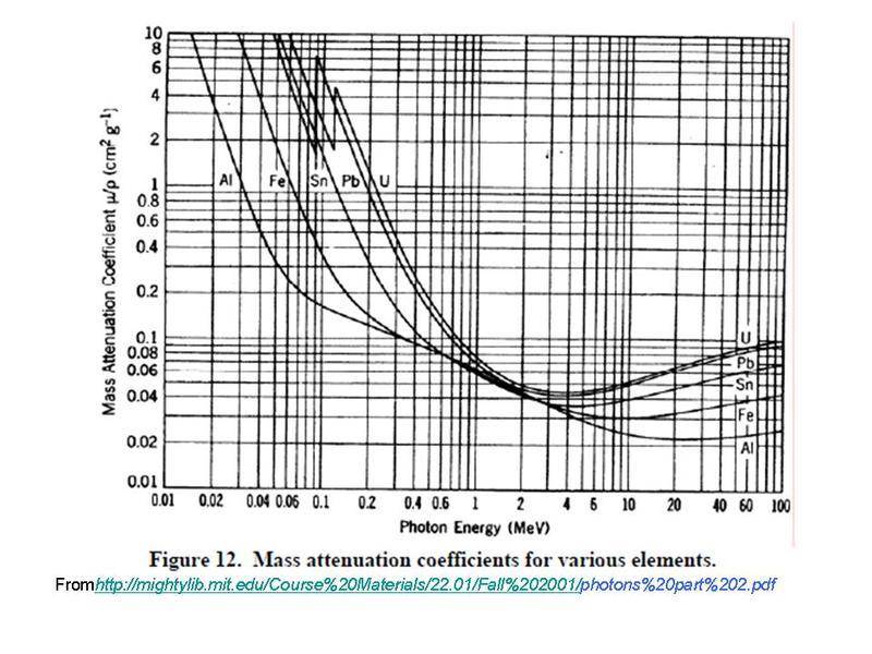

Here in the thumbnail is a good plot of the mass attenuation coefficient for several elements, ranging from aluminum to uranium, and including lead. At energies below 500 KeV, the deep core photoejection attenuation dominates for high-Z materials, and above ~5 MeV, pair production dominates. Between 1 and 2 MeV, Compton scattering dominates for all Z. Lead is a good, inexpensive, and effective high-Z radiation protection material, especially below ~ 500 KeV and above ~ 10 MeV.
For further discussion of the mass attenuation coefficient, see
http://mightylib.mit.edu/Course%20Materials/22.01/Fall%202001/photons%20part%202.pdf
and
http://en.wikipedia.org/wiki/Mass_attenuation_coefficient
Bob S
