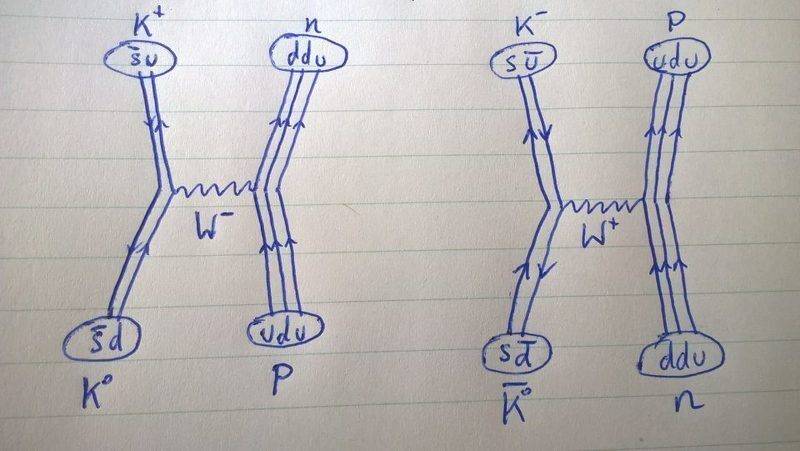

I am simulating lots of [itex]K^0_{L}[/itex] going into a volume of rock, and they sometimes produce a [itex]K^{+}[/itex] or a [itex]K^{-}[/itex]. However, this does not happen in equal amounts - I am seeing roughly 3 times as many [itex]K^{+}[/itex] as I am [itex]K^{-}[/itex]. What is the explanation for this?
Are the K0-nucleon and K0bar-nucleon cross-sections identical?
I'm not sure where to look to check this. If they are different then that would be a simple explanation I think, but what if they are identical?
Also, can you tell me if the following diagrams are the correct interpretation of what's happening?
Two hand-drawn Feynman-style diagrams: left shows K+ (s-bar u) and K0 (s-bar d) exchanging a W- boson with neutron (ddu) turning into proton (udu); right shows K- (s u-bar) and K0-bar (s d-bar) exchanging a W+ boson with proton (udu) turning into neutron (ddu).
OK, take one step back. Are the K+ and K- cross-sections identical? Based on that, what can you say about K0 and K0bar?
The weak interaction is only relevant if there is no strong process doing the same.
Is that as simple as replacing the W bosons in those diagrams with charged pions?

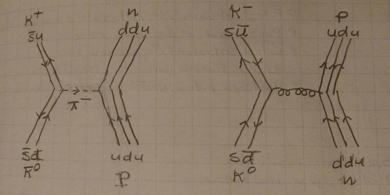

mfb said:
There is an easier process, but the relative contribution might depend on the kaon energy.
Gluon-mediated?
Is this how the reaction diagrams would look like?
Two hand-drawn Feynman-style diagrams. Left: K+ (s-bar u) and K0 (s-bar d) meet and form a pi- via a dashed line, which decays to n (ddu) and proton (uud), labelled P. Right: K- (s u-bar) and K0 (s d-bar) meet with a gluon-like curly line to p (uud) and n (d-d-u).
Note: I would argue that the neutral Kaon is instead the one with the strange quark, and the anti neutral Kaon is the one with the strange antiquark. Is that right?
Feynman diagrams are the wrong tool to solve this problem, especially if they use the wrong interaction or in Garlic's case don't conserve charge.
Where did I make the mistake?
In the left diagram, a neutral particle (kaon) emits a negative charged particle (pion) and becomes positive. A positive charged particle (proton) captures a negative charged particle and becomes neutral.
Is the mistake in the right diagram?
Garlic, the right diagram doesn't conserve charge, and everywhere you have the K0 and K0bar switched. I don't think posting wrong things will help Anchovy.
