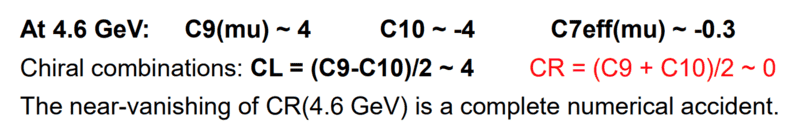

I found this presentation (http://v17flavour.in2p3.fr/MondayMorning/Jager.pdf) which uses 4 for C9 and -4 for C10 at 4.6 GeV on page 8, which is about the region I'm interested in. It's very vague though, so I think just a more precise version of this figure is exactly what I'm looking for

The relevant excerpts from the Jager power point presentation at page 8, cited at #9 in this thread, is:
This is also less clear than it might be about the authority it is relying upon for these numbers.
Q=mb (ca. 4.2 GeV) of Avvincente would seem to make more sense than Q=4.6 GeV in Jager for purposes of these decays. The Avvincente numbers are also at least to two significant digits instead of the one in Jager.
