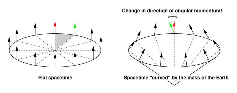

Would an object encountering warpage in space-time change its facing or orientation?
Assume a 2D XY grid, and we'll label the obvious directions N, S, E, and W. Assume an object is just going along a straight line from S to N in flat space with no forces acting on it or imparted to it, including rotational. Let's assume some kind of mark on it so we can keep track of orientation, like a vertical line running up and down the object lining up perfectly with any grid lines you would imagine running N and S. Here, I assume you'd agree that in this situation the line on the object continues to line up perfectly with north-south grid lines.
Assume that the same object then encounters a gravity well or a warpage in spacetime as it moves S to N and gets pulled into orbit. My question is whether the object would or could change facing or orientation, i.e. would the vertical line running north-south up and down the object deviate from north-south. If the answer is "it depends" then give me the scenarios, i.e. if it depends on shape of object, first assume perfectly spherical, then "other." If it depends on shape of gravity well, assume perfectly spherical. If it depends on mass distribution, first assume perfectly uniform distribution of mass and density, then "other."

The Gravity Probe-B experiment was designed to measure two effects. The stronger effect is the geodetic (de Sitter) precession, which is independent of Earth's rotation (to lowest order).

Here is a simple diagram:
From this article, where you can find more explanations:
https://einstein.stanford.edu/SPACETIME/spacetime4.html#geodetic_effect
Thanks.

Depends what "start to rotate" means. The point of the Geodetic Effect (see post #12) is that despite no locally detectable rotation, it can return to a starting position with a different orientation than it initially had there.
