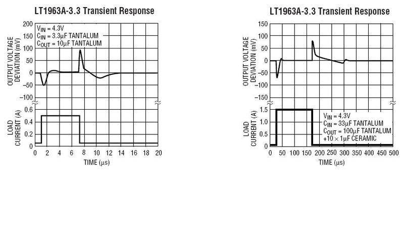

The 12Vdc RF supply needs to handle load transients of .5A and have only a small deviation from the nominal output voltage under these conditions. What is the best way to determine how much output capacitance is required to keep the deviation within a desired limit? Say for example 50mV...
I don't think you'll be supplying that extra 0.5A transient from the regulator's output capacitor -- it will be mostly through the regulator. The smoothing of medium-frequency transients in a linear regulator situation is mostly handled by the regulator itself. Higher frequency transients (like if there is a step in the output current demand) will be smoothed by the output capacitors. The value of the capacitor is important there, but also its ESR (equivilant series resistance) value. If you know the dI/dt value of your current steps, then you can figure out the value of the output capacitor and the ESR required. Check the linear regulator's datasheet to find its transient response characteristics.
The only information that I could find in the datasheet is depicted in the attached image. Would you mind giving an example of how you would calculate the value of an output capacitor given dI/dt?
Those graphs are already showing triensents around 50mV, so the capacitances they list are probably fine for you to start with. Those transients are also almost full scale (off to on), versus starting at 0.5A and having a transient to 1A. An output current transient will generally be handled better by the regulator if it is already conducting a pretty good current before the set up. Be sure to use low ESR caps like the tantalums they mention in the figures.
It will help to keep your 12v sub regulator on the same ground plane as your module and as close to the power connections as possible.
Also, ESR is subject to parallel resistance rules.
All else being equal two 50uf caps will work better than one 100uf cap.
