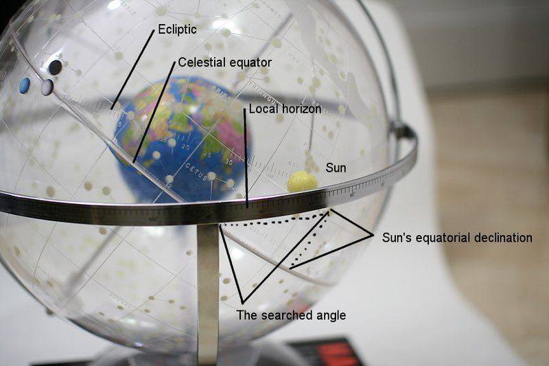

Hello,
I took a picture of my celestial globe (see attachment).
Throughout the year, the sun moves along the ecliptic.
The angle between the celestial equator and the horizon is given by your latitude.
The sun rises as the globe rotates around the axis that goes through earth'poles, parallel to the celestial equator.
Here is what I would have done :
Use the longitude of the sun on the ecliptic as main variable.
Write the relationship between the declination of the sun in the equatorial coordinate system, the ecliptic longitude of the sun, and the ecliptic tilt.
Write the relationship between the searched angle x, your latitude, and the equatorial declination of the sun. This step is very similar to the previous one, except that the ecliptic tilt is replaced by a function of your latitude, and the ecliptic longitude of the sun by the searched angle x.
Solve the equation in order to get x as a function of t and latitude.
Unfortunately, I messed up all the sin, cos, tan, cotan, and signums of the angles, otherwise I would have posted the solution.
Pio2001 is on the right track in that you take the declination of the astronomical body. In this situation we are only concerned with the sun. The sun moves between the Tropic of Cancer and the Topic of Capricorn or from 23.5 degrees south to 23.5 degrees north. To get declination you can use a formula or use on of several sites on the Internet.
http://www.wsanford.com/~wsanford/exo/sundials/DEC_Sun.html
http://en.wikipedia.org/wiki/Declination
What this mean is that today, the sun is directly over 16 degrees 46 minutes of latitude south of the equator.
To make it easier it is simpler to think of the position of the body as a point on the surface of the earth, rather than in the sky. It is called the sub stellar point and defined as the point on the surface directly beneath the heavenly body at any given instance of time and where the line joining the body to the center of the Earth cuts the surface.
There are still more information needed such as GHA, which I don’t know how they calculate.
However I found a simple formula that works reasonably well:
True Azimuth angle Cos-1 = (sin declination)/(coos latitude).
Where declination is the declination for the day and latitude is the latitude at your location.
Azimuth angle is measured from True North so if you want the direction in magnetic, you have to concert.
Also both the declination and latitude can be either north or south of the equator. For instance in the northern hemisphere at this time of the year the declination is S, and in this case you use a negative declination (eg –16.48). If they are both declination and latitude N or S there is no negative sign.
Or: Names the Same it is a Plus
Names not the Same it is a Minus.
Or you can use one of the online calculators. This one calculates the sunrise at your location. Just enter your Lat and Long and time difference from UTC and it tell you when the sun rises. Note: to enter lat and long directly you must select where it says Boulder and then select lat/long otherwise it defaults back to Boulder
http://www.srrb.noaa.gov/highlights/sunrise/sunrise.html
From there you can go to the site below and enter the location and set time equal to sunset or sunrise from previous site. If Alt is negative it means sun is below horizon.
http://jamesrbass.com/sunform.aspx
