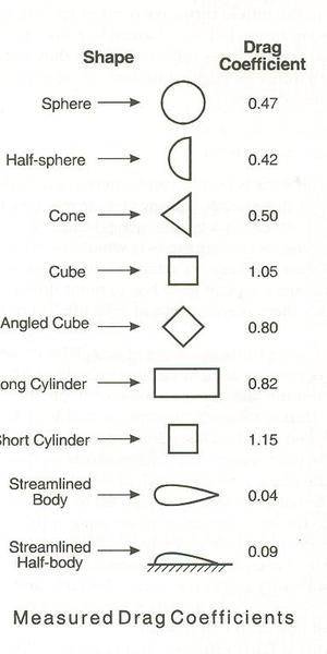

good start! and yes..anytime you are moving..you are moving air..imagine a curtain that weight 14 pounds per square inch, stick your hand out the car window when moving 25 MPH. what kind of ground clearance can you get away with...lower the better to keep air out from under the vehicle.
being old ..ancient school..what the H? is KM/H...
how much horsepower is that?
your CDs seems a little low..check out the attached..
a 440 pound car to me should not have that much rolling resistance..are you running disc brakes on all four corners?
with that low a weight you can loose the disc brake pad drag and go with drum brake and shoes ifin you want to really go for the MPG numbers..ifin you really want to trick out the set up, go super light on the rotating mass, wheels, tires, drive train..what kind of transmission...lot of parasitic drag on components..flywheel ..what diameter? drive shaft or half shafts?
can you go carbon fiber? gun drill them?
also regarding the IC,,can you u duct cold air to the intake?
can you up the water temperature to 240 degrees F..more heat makes more HP..can you run synthetic oil and differential grease in it.. all these will increase HP or fuel mileage.

Ok..forces opposing motion
with 36 kph (10m/s) as the max speed, and about 27 kph (7.5 m/s) as the average speed:
1. Drag (with Cd~0.25, A=1, air density=1.2)
= 15 N at max speed, 8.4 N at average speed
2. Rolling resistance (Cf~0.03, W=200x9.81 N)
= 58.9 N
3. Gradient (max grad~5%(0.05))
= 98 N
(although this is a big fraction of the total opposing forces, this only acts in a portion of the track. i don't think it needs to be kept into account if have enough kinetic energy at the bottom to negate the potential energy change and losses, even if the engine is turned off) so i am not going to use this in the power calculations
Power required to overcome
1. Drag = Drag*velocity
= 150 W for 36kph, 63.3 W for 27kph
2. Rolling resistance = RR*v
= 588.6 W for 36 kph, 441.5W for 27kph
Total max power = 150 + 588.6 = 738.6 W
Total average power = 63.3 + 441.5 = 504.8 W
Now, i have in mind to use gears in two stages, firstly as the 'transmission', and then the final drive reduction by a chain-sprocket assembly. Assuming efficiencies to be 73% (85% x 85%)
power of the engine = 738.6 / 0.73 = 1.012 kW
so i need an engine that gives me this much power right?
then i need to get engine charts for that engine to get the projected mileage?
