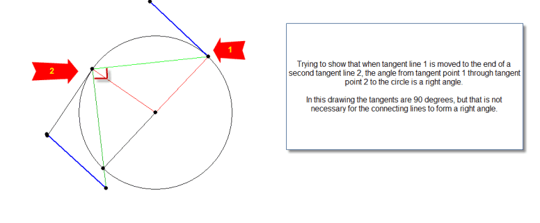

This is probably a geometry question more that a physics question. I am trying to prove that in uniform circular motion [tex]\Delta[/tex] V[tex]/[/tex]V= s[tex]/[/tex]R.
I am basically trying to show that S forms a right triangle with [tex]\Delta[/tex]V, when [tex]V{1}[/tex] is added to [tex]V{2}[/tex] as a vector. (This is to demonstrate that the triangles are similar.)
I understand that the angle formed by S and [tex]\Delta[/tex]V is a right angle because it obviously inscribes the diameter. I just cannot seem to find a satisfactory proof that [tex]\Delta[/tex]V must necessarily intersect the circle at the diameter.

If you are solving geometry problems with both distances and velocities involved, then you
are probably making a mistake: remember that they have different units! (unless you study relativistic theory)
For the mentioned problem you should use formulas:
s=R*fi (fi is angle of the part of orbit traveled in radians)
[tex]\Delta[/tex]V=V*sin(fi') (fi' is the angle between the old and new velocity vector)
Prove that fi=fi' and use sin(fi)=fi (for small angles) and you will get [tex]\Delta[/tex] V[tex]/[/tex]V= s[tex]/[/tex]R
Thank you so much for responding. I think though my question which started with uniform motion and delta V, is now simply a geometry question.
I will try to put up a drawing of what I so pitifully tried to explain.

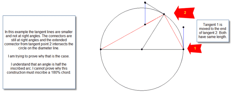

Here is another image with a different angle and size of the tangents.
I have tried several approaches, but I cannot prove that the angle formed from tangent 1 to tangent 2 to the circle must inscribe a 180 degree arc and must be a right angle.
From : http://en.wikipedia.org/wiki/Inscribed_angle_theorem
In geometry, the inscribed angle theorem states that an angle θ inscribed in a circle is half of the central angle 2θ that subtends the same arc on the circle.
So, to get an inscribed angle of 90° you need a central angle of 180°(=diameter line).
