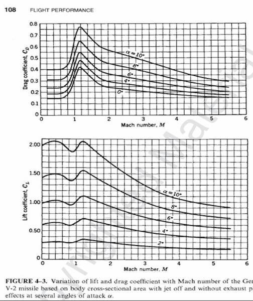

Here's the plots for the V-2
Sure...
Is there something wrong with Fred's graph? If so, please point it out.
I honestly don't know why you think the drag coefficient is a constant, it is not. At a freshman level, it varies with angel of attack. We both already know this, but I don't understand why you won't accept it. You seem to be caught up in nomenclature, all the drag coefficient does is represent something physically. It is a 'coefficient' and I say that in quotes, at each slice of time. At each instant we can think of it as a constant. But in general it is a multivariate surface! (It's an n-dimensional function)
I have never seen anyone state the drag coefficient is a constant - ever. You are going to need to have some references here. Even Anderson 4ed, chapter 1 p.84, has plots of drag coefficients as early back as the Wright brothers. There is even a chart of variation of normal and axial forces for various angles of attack by Lilienthal circ. 1897.
