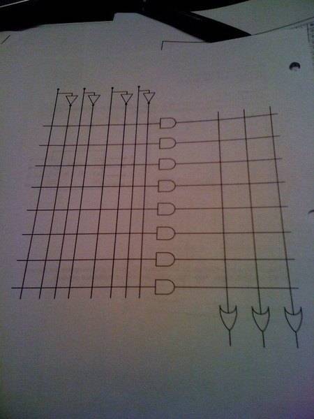

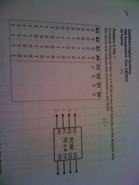

a) complete the table for the 16 x 4 ROM shown and indicate on the diagram how the inputs and outputs are connected to the ROM.
b) Show your K-maps for functions F, G, and H and complete diagram on following page. Note that only 8 product terms are needed.
none
In order to do the truth table, don't you need some sort of functions? In part b it says to k-map functions F G and H. But it doesn't give us an F G or H. And wouldn't there need to be 4 functions for the 4 outputs? And I don't see why only 8 terms would be needed for the diagram either. I can't see how this is possible to even start.

Well, one of the outputs is marked as an X, presumably meaning "don't care" because it isn't used. But otherwise, yeah, you're going to need F, G, and H. Go ask your teacher for the rest of the problem.
Alright good, I thought I knew how to do these and this completely threw me off. I'll ask him for it tomorrow.
Thanks
