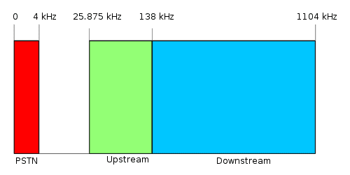

This is the spectrum of what is on your telephone wire in your house.
The red part is your normal phone voice part.
The green is the transmit signal from your modem.
The blue is the receive signal. This will be on the same wires as the green signal and a lot weaker than the green signal.
So, if you cut the wire and put an amplifier into amplify the receive signal, what would happen to the transmit signal? It would have to go backwards through the amplifier and it can't do that.
Your ISP has probably told you that the signal reaching your house is too weak and noisy. If you amplify the signal (even if you could) you will just get a bigger noisy signal.

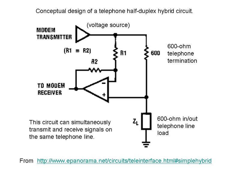

Here is the schematic of a full-duplex telephone hybrid circuit implemented with two op-amps. The transmitted signals and simultaneous received signals share the same 600-ohm line without interfering.

Bob S: Assuming we have to cut the phone line, how would you implement a practical device with that hybrid circuit? The modem is expecting a combined signal again after any amplifiers.
Do you feel it would have 1 MHz bandwidth? It looks like an audio device with quite large capacitor values.

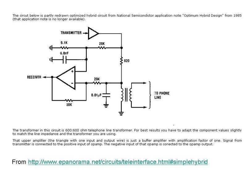

Here in thumbnail is the conceptual design of a telephone DAA (data access arrangement). The transmitter does not interfere with the receiver, even though both use the same telephone line simultaneously. I believe the circuit in my previous post uses the two capacitors for a low pass filter on the receiver side..
