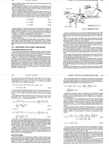

I am wondering if anybody understands the Raymer neutral point formula? I have attached the formula for reference.
Even just an example would be good enough.

His neutral point formula comes from the datcom method. Are you familiar with that method at all? Also it would help if you could tell me which terms you do not understand rather than explaining them all.

- F_p_alpha
I think this is the force of pressure with respect to alpha on the wing, but I have no idea how to calculate it.

Hey I checked my old stability notes and the neutral point formula we had was slightly different. Meaning it was meant for a different geometry. However, for all the definitions you posted, you were spot on except, [tex]F_{p_\alpha}[/tex]. I have no idea what that denotes.
In my mind this leaves 1 of two possibilities:
1)I know that Raymer gets his information from many sources and combines certain things. So you'd have to find the source where he used this equation
2)I know that Datcom uses a component buildup method. So I am thinking this aircraft has a certain configuration and utilizes a component which was denoted with subscript 'p'.
I'll have to do some snooping around to see what's going on.
F in this formula signifies the propeller or inlet force. I know this is an old thread but for anyone looking for some clarification check out the image I attached it goes over the basics from the text Aircraft Design a Conceptual Approach by Raymer
