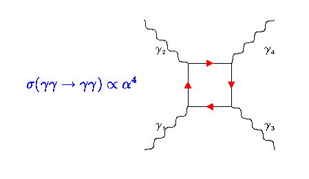

There is indeed a 1-loop contribution to the process [tex]\gamma\gamma \rightarrow\gamma\gamma[/tex]. Any charged particle can run in the loop, but the electron dominates because of its small mass.
For the process (e+)(e-)->photon + photon the simplest Feynman diagram is just half of what you've drawn, but I'm confused about the propagator. I initially joined the two vertices for the above process with a line propagator (with no arrow) but in your diagram you have included arrows. I initially thought that vertices that coincide at the same time cannot have any arrows because it could mean the transfer of a particle of anti particle. On the other hand vertices that do not correspond to the same time can have an arrow on the propagator joining them since we know which way the particle is going (forwards in time). My time axis is horizontal by the way.
I think I see the answer now. If we know the direction of the arrows for the horizontal propagators then we must know those of the vertical propagators.
I'm not sure what you mean about vertices coinciding in time. If we were to compute this amplitude in spacetime rather than momentum space, we would integrate over the location of the vertices. In any case, the arrows are conventional. Matching the directions of the arrows when forming diagrams helps to ensure that charge is conserved, momenta match up, etc. In the case of the loop, they correspond to the direction of the momentum going around the loop.
