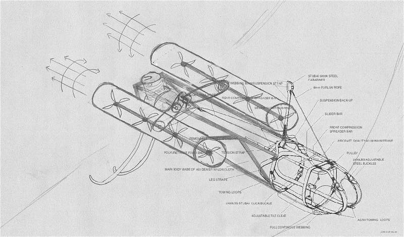

I have attached the reason to why I am asking all of these questions (ignore all the small labels). It is my concept for a powered hang glider harness. The design is still in its most primitive stages, but I do not want to continue with it if there are big issues to start with.

Wont work as shown without careful consideration of the turbulances in the tube most likely you will just produce a lot of vibration and noise in the rear fans without careful work.
If all you are trying to do is control glide your idea will be fine but human powered flight (http://en.wikipedia.org/wiki/Human-powered_aircraft) is all about lift efficency because the power any given person can produce is limited.
Does not matter what blades etc you use by the laws of physics you can not get more energy out than you put in so power to weight ratio for lift is the guiding factor.

Would putting each propeller on its own free spinning axis work help with the turbulence? or am i missing the point...do you have any recommendations to decrease the turbulence? Which things do i need to consider?
You can use a flow straightner between fans but I suspect you will lose a lot of energy. They are nothing more than a grill of small length pipes or hex or octogons in your tube

Wow! those air straighteners work amazing! i will definitely consider that in my design.
Also, I do realize that centrifugal fans produce more pressure, but they are bulky. Weight needs to be a minimum for a hang glider.
