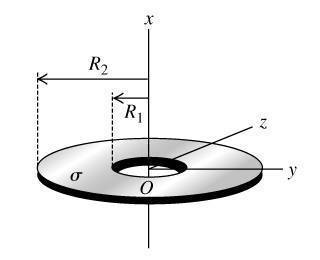

A thin disk with a circular hole at its center, called an annulus, has inner radius R_1 and outer radius R_2 (there's a picture which I will try to describe as best I can at the end of question). The disk has a uniform positive surface charge density δ on its surface. (a) determine the total electric charge on the annulus. (b) The annulus lies in the yz-plane, with its center at the origin. For an arbitrary point on the x-axis (the axis of the annulus), find the magnitude and direction of the electric field E (bold for vectors). Consider points both above and below the annulus.

Here's the image:

nateja said:
Then Part B (I'll try to explain in as clear terms as possible).
I divided the annulus into rings of area (2π(dR)^2)-(2π(R_1)^2). dR being an infinitely small distance for the 'outer radius.'
You should have rings with inner radius R, and outer radius R + dR.
The area of such a ring is dA = (2πR)dR .
Have you covered the E field due a ring of charge -- either in class or in an assignment?
We did the second problem I showed you. But I think I figured it out. My professor showed me the cylindrical coordinate system and it was a little easier to solve it that way.
Ended up double integrating first for d∅[0,2π] then for dρ[r_1, r_2]. Thanks for you help. I have another question for part (c):
c) show that at points on the x-axis that are sufficiently close to the origin, the magnitude of the electric field is approximately proportional to the distance between the center of the annulus and the point. How close is "sufficiently close"?
d) A point particle with mass m and negative charge -q is free to move along the x-axis (but cannot move off the axis). The particle is originally placed at rest at x = .01R_1 and released. Find the frequency of oscillation of the particle

I corrected it:
E = -(x*δ)/ε_0 * 1/sqrt(R_2^2+x^2) + (x*δ)/ε_0 * 1/sqrt(R_1^2+x^2)
Now I am trying to take the limit of this function as it approaches 0. However, I just get 0 due to the x term multiplying in the function. Is this the answer? it makes sense to me because there will be no x component to the E vector.
nateja said:
I corrected it:
[itex]\displaystyle \vec{E}=\frac{x\delta}{\varepsilon_0}\left(\frac{1}{\sqrt{{R_1}^2+x^2}}-\frac{1}{\sqrt{{R_2}^2+x^2}}\right)\hat{i}[/itex]
Factor out R12 and R22 inside each radical, then take each out of its radical:
[itex]\displaystyle \vec{E}=\frac{x\delta}{\varepsilon_0}<br /> \left(\frac{1}{\displaystyle R_1\sqrt{1+\frac{x^2}{{R_1}^2}}}<br /> -\frac{1}{\displaystyle R_2\sqrt{1+\frac{x^2}{{R_2}^2}}}\right)\hat{i}[/itex]​
Now consider what this approaches for x << R1 < R2 .
