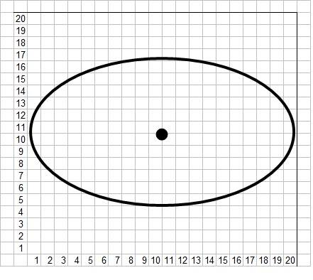

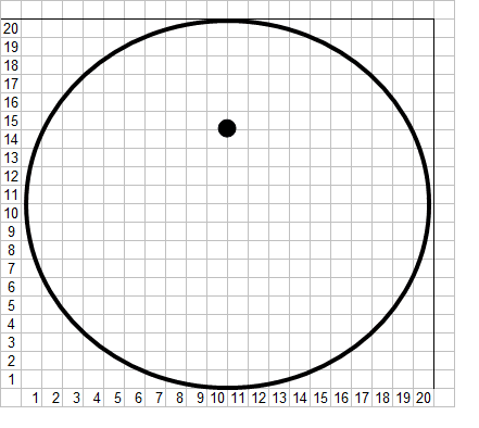

It took me a while to finally see where the following scenario is wrong.
I found it a "fun one" to consider.Scenario
Observer A moving at 0.5c compared to observer B.
Observer A sends out an idealized light pulse in a perfect circle. Perhaps by using a single light source & through diffraction of sorts is redirected in a perfect circle, expanding outwards at c.
Image one is from the PoV of observer B who I'll say is at rest.
Image two is from the PoV of A who is moving at 0.5c compared to B.
two
Ignore the difference in diameter (timing of the image).
I had always been confused how observer A could determine that B measures them self at the centre of the circle. Given observer A sees them near the "top" of the circle, I was able to explain the "contracted" length that is "seen" near to top of the circle, but had no clue what explains the "elongation" at the bottom.
After sometime, I finally realize that my scenario is a fallacy. ( at least I think it is)

yea, It's a good one! In the "rest frame" image below I can "see" length contraction (A). That is I know, since c is constant Observer A would measure themselves in the centre of the light pulse circle, I can understand that due to a contracted ruler observer A measures a longer distance to the light pulse in front then the "contracted" space seen from the "rest" FoR image.
How can observer B account for observer A's measure of length to the "rear" of the circle (B) that would place them in the centre? (this is practically giving up the fallacy of the scenario)

Kinda misunderstood the scenario, A is in motion and only A generates the pulse.
The first image is how observer B sees the scenario (this is why I can say observer B is at rest)
The second image is how Observer A measures the scenario.
How can you account for the measure of the "bottom" length as performed by observer A; who measures them self in the centre of the circle.
Just to be crystal clear the letters A & B in the above image are just for identifying two measurements; not the two observers.

Your first image looks to me like it is for observer A who is traveling, not observer B. That's one thing wrong.
Your second image looks to me like it is for observer B who is at rest. That's two things wrong.
You indicated that each observer is determining that the other observer is at the center of the circle of light. That's wrong. Each observer determines that he himself is at the center of the circle of light, he has no opinion about the other observer.
You indicated that one of the observers concludes that he is near the top of the circle and far from the bottom of the circle but you have not explained how he makes that determination. It's wrong for you to make such statements without telling us how the observer is supposed to figure this out.

k, so only Observer A makes a light pulse. Both images are of Observer A.
Image one is what Observer B sees when looking at A. This is because A is moving, B sees A in the position shown in the first image. I hear you ghwellsjr about the pictures not being very clear. In the first image, observer B is seen near the top of the circle, at the end of the blue line that indicates the motion of A.
Image two, is how Observer A would see them self.
In the second image A observes them self in the centre of the circle.

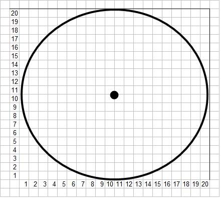

I'll post an image showing what A sees, if B sees the light pulse as a circle. It might make it more clear.

Alright, so if A immits a light pulse in a perfect circle from their PoV, then here is the shape of the light pulse circle from B's PoV.
Note because of the invariance of c, "length contraction" is visable as the shape of the light pulse, of course this not actually length contraction but merely shows that A did not fire the light pulse as one event from B's PoV, from A's PoV it was a single event.

You're assuming that A doesn't see the light pulse as circular and using this to produce your "definition". It doesn't make sense. An event has no velocity, it doesn't define an inertial frame. You can define motion relative to a particle, but not relative to an event.
Try this: A and B both carry a light source. When A and B coincide, both A and B send a light pulse. Two light pulses are sent, at the same time and from the same place. How can A see the light from his own source expanding in a circle and the light from the other source not expanding in a circle? That would mean that A sees the light from one source moving at a different speed to that of the light from the other source.
What I thought was going to give it up for sure was A not being in the centre of the circle for both images. as clearly would be the case since there is no spatial separation and it is a "single" event. the only other thing to account for RoS is simply a disagreement on when the light was emitted from the souce, which in turn effects the shape of the light pulse.
you're assuming they both actually see a circle, because of RoS and invariant c, it cannot be the case.
nitsuj said:
Yes & length contraction accounts for the measure from the "top" of the light pulse circle, how is the measure to the bottom of the light pulse circle accounted for?
Note intervals are invariant. The interval between observer A and the bottom of the light circle is not the same as the interval with A in the centre of the circle.
The length contraction formula is for rigid objects. The light circle is not a rigid object: the "bottom of the circle" and the "top of the circle" do not happen at the same times for A and for B. If B is surrounded by a circular mirror (as in the animation), he sees the light hit the "top" and the "bottom" of the mirror at the same time (in the animation, it's the right side and the left side of the mirror). For A, these two events are not simultaneous: A sees the light hit the top of B's mirror before it hits the bottom if B's mirror. Note that A sees B's circular mirror as an oval (length contraction) but A sees the light from the flash emanating in a circle.
Once more, any observer must see the light from a flash emanating in a circle, precisely because c is invariant.
