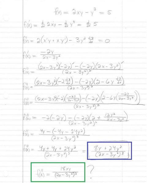

Here is my work/attempt. In blue is my answer. In green is the supposed correct answer.
The first derivative is surely correct, as it matches the answer I was supposed to get. However, if my second derivative answer is incorrect, can you determine where I I am making a mistake?
Here's a hint: your mistake comes on the third to last step (the line beginning f''(x) = -2(-2y)

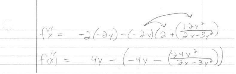

Would it be correct to approach this step like this:
EDIT: On the first line, please regard the 12y^2 as just 12y. The second line is written as though the 12y is what I started off with.

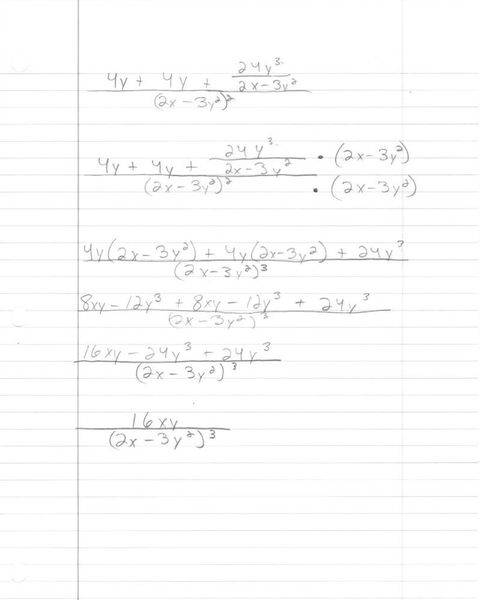

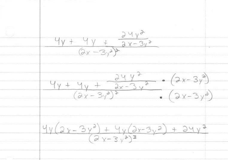

Your mistake is in the 3rd to last step, where you have one term with a 2x-3y^2 denominator. In the following step you simplified the equation by multiplying (2x-3y^2) with the (2x-3y^2)^2 term. However the two 4y terms on the numerator were not being divided by 2x-3y^2.
Would this be the correct way to do that step?
Okay, I was able to get the answer in the right form as the provided answer. However, it is off numerically by 2. The provided answer has 18xy and my answer has 16xy. I have always known 8 + 8 to equal 16...what gives?
