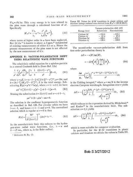

Virtual electron positron pairs are created in vacuum (as virtual pairs) in a strong Coulomb field around charged particles, and they "shield" the true (unrenormalized) charge of protons and nuclei. This polarization of the vacuum was first calculated by Uehling* in Phys Rev (1935), and used to correct the atomic energy level measurements in pionic atoms. See Apppendix 2 in Robert E. Shafer Measurement of Pion Mass Phys. Rev. 163, 1451 (1967). See attachment.
* Serber also in same issue of Phys Rev

I think that Uehling's model for the disturbance of virtual electron positron pairs in strong Coulomb fields is a real effect
Phys. Rev. 48, 55–63 (1935) "Polarization Effects in the Positron Theory"
and has been rigorously tested in recent years (muonic and pionic atoms) and found to be still correct. So are we just arguing semantics?
See http://philoscience.unibe.ch/documents/physics/uehling35/uehling35.pdf
