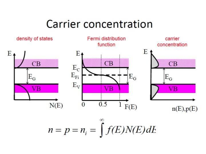

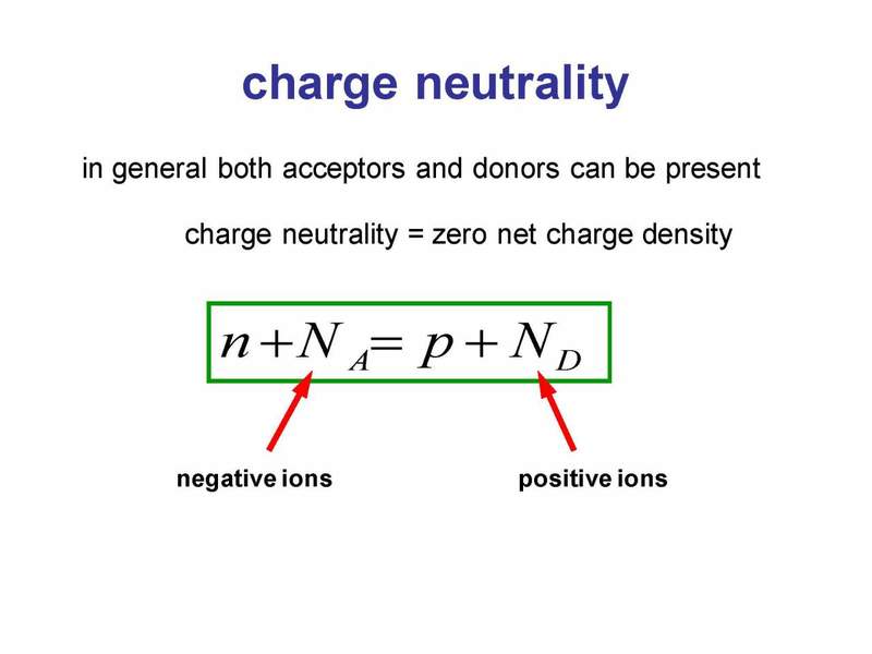

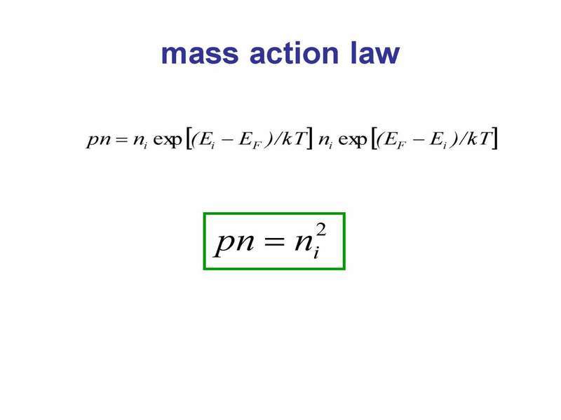

hey guys i want to know the definition of these terms & what are they but please i don't want big words because i won't understand i want to understand it simply:
1-Fermi level
2-Density of states
3-Carrier concentration & the graphs (in the attachment)
4-Mass action law
5-Charge neutrality
i attached some files because i don't understand what it is saying

Do you have any chemistry background? Because the easiest way to think of the Fermi level is as your highest occupied orbital. The major difference is that in a crystal structure, your discrete atomic or molecular orbitals blend together into bands of energy levels (so it isn't a Highest Occupied Molecular Orbital, it is instead called the Fermi level). Your density of states diagram is then analogous to a molecular orbital diagram. The big difference is that you once again don't have discrete energy levels, you now have a probability distribution for possible electronic states.
Fermi level: At zero temperature everything below is occupied, everything above is empty. At finite temperature things get smeared out a but, according to Fermi-Dirac statistics.
Density of states: How many electrons can you fit at this energy? There can be occupied and unoccupied DoS, so you have to be a bit careful sometimes.
Charge neutrality: Just what is says. Number of positive charges (holes and donors) = number of negative charges (electrons and acceptors)
Mass action law: Read the equation. Concentration of holes times concentration of electrons is a constant.
Carrier density: Number of mobile electrons that can carry an electric current. Depends on the DoS and the probability to find an electron or hole there (Fermi-Dirac statistics)
