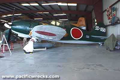

I've been trying to find information on the J2M concerning it's airfoil which is listed as "laminar flow" but is not represented by a naca number.
Naca Airfoils are not necessary laminar. If you are looking for specifically designed laminar airfoils look for the NLF (Natural Laminar Flow) designation.
There is no reason why a J2M would have a NACA designation given the fact that it was a Japanese design at a time when Japan and the US were not exactly on speaking terms. It is the same reason you won't find a NACA number for something like an Me 262 or a Ju 88 or any other axis-designed aircraft.

Because I do aerodynamic testing at NASA, rebuild warbirds for the smithsonian, and I was curious because this is one of the few planes we don't have.
There is test data from freeman field but not much detail on the wing has been published.
Never mind guys...I'll just visit chino and measure it.
