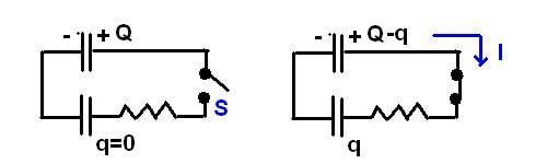

The capacitors are connected with a wire. That piece of wire has got some resistance, so it dissipates energy. The smaller the resistance, the higher the current. Current will flow till there is potential difference between the connected plates of the capacitors.
Before connecting the capacitors, the charge of the first is Q. After the switch is closed, current starts to from the positive plate of the charged capacitor to the uncharged one through the resistor R. At time t, the charge of the second capacitor is q and that of the first one is Q-q. According to Kirchhoff's first law the sum of potential differences in the loop is zero.
(Q-q)/C-IR-q/C=0. The increase of charge q in time dt is dq=Idt, so I=dq/dt. Substituting into the equation, it is a differential equation for q with th einitial condition q(0)=0. The solution is
[tex]q=\frac{Q}{2}\left(1-e^{\frac{-2t}{RC}}\right)[/tex]
The current:
[tex]I=\frac{dq}{dt}=\frac{Q}{RC}e^{\frac{-2t}{RC}}[/tex]
In equilibrium (at infinite time) q=Q/2 and I=0.
The initial energy stored in the the charged capacitor is E(0)=Q2/(2C). The energy of the two capacitors becomes Q2/(4C) altogether. The missing energy is equal to the energy dissipated on the resistor during the charge-redistribution process:
[tex]W=\int_0^{\infty}{I^2 Rdt}[/tex]
ehild

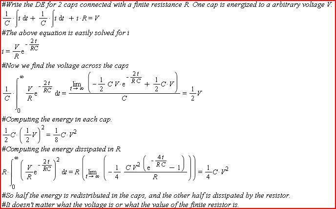

echild,
I cannot argue with your correct result. But I hope you realize that the charge Q is the separation of charge on the cap, and not any charge the cap is storing.
OK, the attachment shows that any finite resistance will suck up half the energy stored in a energized cap connected to a cap that is not energized.
Ratch

echild,
Ratch

ehild,
By the way it is said that the capacitor is a device to store charge
"It" is wrong. It is a device to separate charge, which in turn takes energy that the cap stores.
If one plate of the capacitor is grounded, and the other plate is given charge, that charge is stored on the capacitor and can be used later.
"Ground" is just a reference point. The charges are still separated, and there is still a voltage difference which indicates an energy storage.
What is "V" in your attachment? There is no source in the loop of the connected batteries.
"V" is the initial voltage on the energized cap. It is mathematically the same as a constant voltage source in series with the cap.
Ratch
