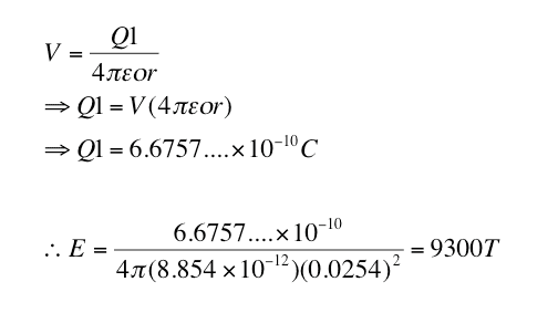

Ok, so from equations to give V and E, I've come up with this as a potential solution for the first E value from the first two values of distance and voltage. Is this correct?
No need to plug in numerical values yet; you have a whole table full of values to plot later. Just write the expressions for potential and electric field for a point charge. Solve the potential expression for Q and substitute it into the field expression. That'll leave you with an expression for E involving only V and r. You can plot that since you have a table full of values for V and r.
(as an aside, note that electric field strengths are given in V/m or N/C, not Teslas which are a measure of magnetic field strength)
