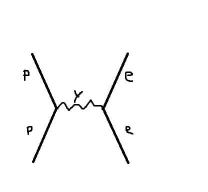

question dude
80
Would it just be the same as with two electrons? (or any other pair of particles with the same charge)
I'm kinda in two minds, I suspect that is wrong because wouldn't the fact that they attract each other (instead of repelling) means that the diagram would be drawn differently?
no that wouldn't change the diagram it just changes the sign in the feynman rules for the vertex (ie for electron and -ie for the proton, or the other way around)..
but I am not sure if you can use this diagram since the proton has constituents,, I think it works in an "effective" description.
so the diagram is correct?

This isn't about scattering or any high level physics-sounding stuff. This is just a question in my school textbook, asking me to draw a feynman diagram showing the electromagnetic force between a proton and an electron.

yeah it does go in depth into explaining quarks, but that's several pages later on after this current question I'm doing
so if I assume the proton as being a fundamental particle with the opposite charge to an electron, is the diagram I posted correct?
Yes..it is correct...don't forget to show the time follow (for example from bottom to up). Also, you should say if we consider the proton as a fundamental particle then the EM interaction between electron and proton is .. one you posted)
In this case, just don't forget to draw the arrows! However, this seems to me like a careless introduction of Feynman diagrams within a pedagogical text.

andrien, the asker is in high school. If you're just going to give a highly technical answer that is obviously beyond the level of someone asking a question, you might as well not respond at all. In fact, it would probably be preferable to do so since receiving explanations that have no awareness of the audience just gets people frustrated.
question_dude, there have been a few good answers here, but I think your above question indicates a bit of confusion that hasn't been addressed. It's important not take Feynman diagrams too literally. The only thing that matters physically is which bits are connected to what. So, when we draw the lowest order diagram for two electrons interacting, the fact that the legs for the two outgoing electrons are drawn pointing away from each isn't physically significant. So, for two electrons, this diagram (read left to right) is the same however you choose to rotate and twist the different pieces of it. What tells us two electrons repel each other is when we actually use the diagram to calculate the probability that two electrons with particular initial momenta will scatter off each other into two electrons with two particular final momenta. If we do this, we learn that it is more likely that by exchanging a photon the electrons will be scattered away from each other than scattered towards each other—a repulsive force.

No, is the correct answer. However, the problem is A-level textbooks contain a lot of garbage and written by non-expert. So, if you answer by No, which is correct, you might not get any mark.

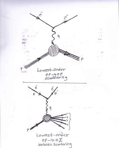

A Feynman diagram is a shorthand for a calculation. There are two different ideas that are getting entangled: is the calculation done correctly, and are the calculation's approximations (and since this is a truncated perturbation series, there will always be approximations) valid?
For Mott scattering, when calculating using Feynman diagrams the target (in this case, the proton's) charge appears only as Z2. So at 1st order, electron-proton and positron-proton scattering is the same. There's a very nice QM treatment of this in Schiff (p.141) where he shows the difference between attraction and repulsion is proportional to 1/v - i.e. for one to distinguish attraction from repulsion, the projectile needs to spend a lot of time near the target. This agrees with our classical intuition, and it corresponds to the case in the Feynman perturbation series of many photon exchanges. When texts make the usual Mott approximation that m_e is zero, that of course is far away from the large 1/v situation where attraction and repulsion are distinguishable.
For the proton's form factor, of course it has one, and in certain kinematic regions - large momentum transfer - it is important. In others, it is not: in particular, so long as the projectile wavelength is large compared to the target radius, the target appears more or less pointlike. In this kinematic range, there is nothing wrong with treating the proton as a point. (For a purely electric interaction - there's a subtlety with the gyromagnetic ratio for purely magnetic scattering) This is no worse than treating the proton as a point when applying Coloumb's Law at large distances - indeed, it is the exact same approximation.
samalkhaiat said:
This is why we draw a blob (instead of a point vertex) representing two independent Lorentz-invariant FORM FACTORS and reflecting our ignorance about the proton structure.
