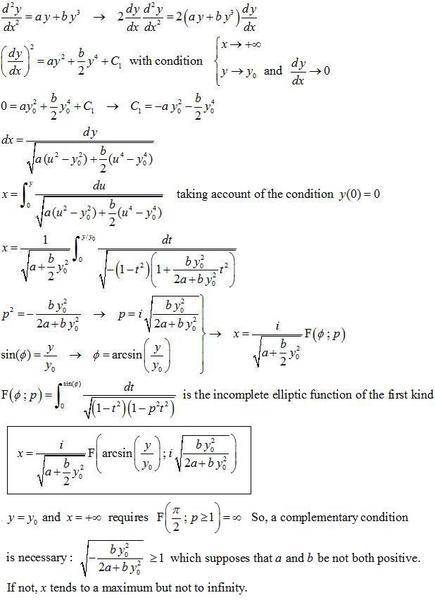

Hello !
It is a difficult problem on the analytical viewpoint.
A difficulty is that elliptic functions are involved. But the major difficulty is due to the condition f(x=+infinity)=finite constant.
I am not quite sure that the solution given in attachment is a correct answer to the problem, so it should be carefully verified.

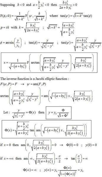

In case of some complementary conditions specified in attachment, y(x) can be fully explicited thanks to a Jacobi elliptic function.
:approve:Nicely done Jacquelin and beautiful too. Thanks.
