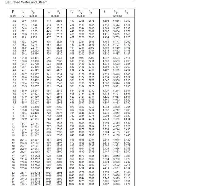

Start from the beginning. 0.6kg of wet steam at a pressure of 5 bar. What is its temperature? Remember, the water in this mixture must be at the boiling point for the pressure given.
Ok if according to the steam table @ 5bar, the temperature should be 151.8°C
Very well. Now that you know the temperature and pressure, what is the volume? Compute separately the volume of the saturated steam component, and the volume of the water component.

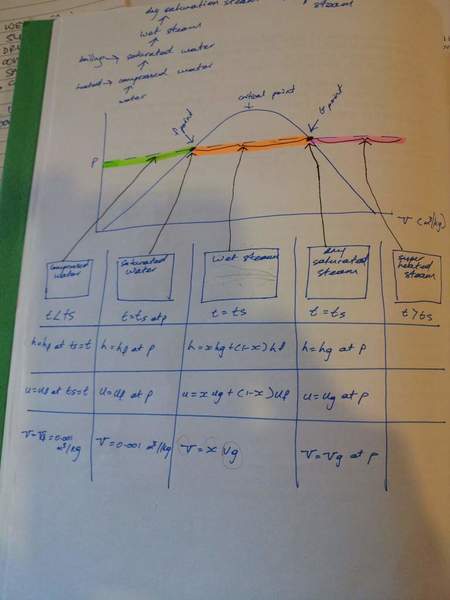

This is what i know:
compressed water > saturated water > wet steam > dry saturated steam > superheated steam
"so you have saturated steam." what steam are you talking about here, dry saturated?
Thanks.

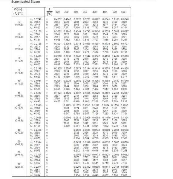

In a closed system, 0.05.kg of dry saturated steam is heated at a constant pressure of 8 bar until the volume is occupied is 0.018m3
(A)Calculate the change in internal energy, the work energy transferred and the heat energy transferred during the process.
For this question how do I determine? dry saturated steam and superheated are both steam, no water components in it.

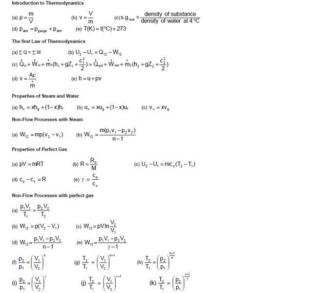

Dry steam is basically an ideal gas, forget about phase transitions and use the ideal gas laws.
What do you mean by ideal gas laws?
"perfect" gas as per your formula sheet.
I thought this question is on non flow process with steam?
I am not given R/Cp/Cv/Gamma, how do I use U2-U1=mCv(T2-T1)?
