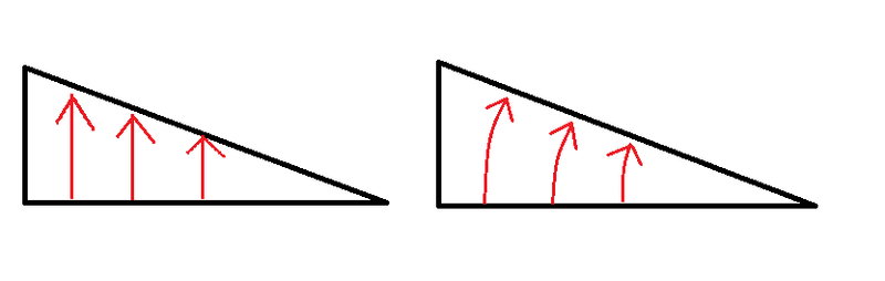

I think we're on the same page here in understanding that a "2D" model done in slices to account for the changing thickness is truly just a series of 1D models. Or are we thining about different ways to approach this?
See attached for the 2 heat flow lanes. One shows what the model would show and the other something a little more realistic (slightly lol)

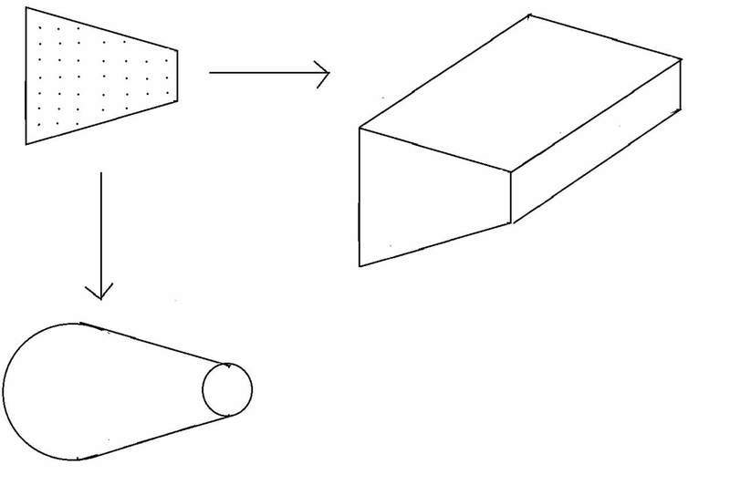

No, not slices! The 2D-plane is the same as in your sketch.
The 2D plane can account for the fact that the heat won't flow only perpendilcar to the inner pipe. True. But it doesn't account for the curvature of the cone. It assumes that the z-direction can be neglected b/c the the length in the z-direction is very long. See pic attached
The formulas for the individual elements do that. The problem is similar to this or this one (but with easier boundary conditions).
No, it does not.

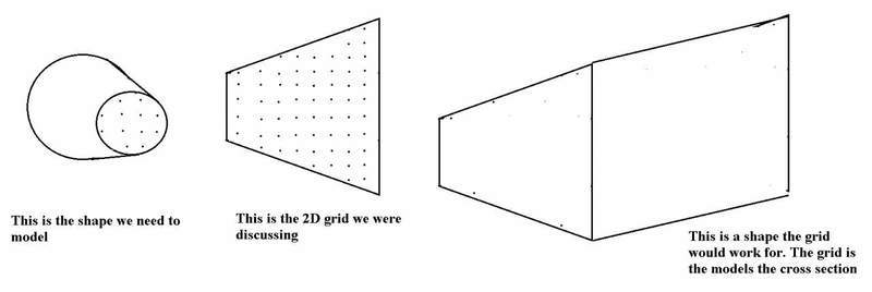

So, in a nutshell, correct me if I'm wrong. There is no way a 2D time-marching model can definitely account for the curvature of the cone.
See attached
If incorrect explain why.
Fine: You are wrong. See all previous posts for explanations.
In 200 words or less explain how the the grid in the last attached picture can both simulate a object that is long in the z-direction and round.
If not, you sir are wrong.
The formulas how grid cells are influenced by their surrounding cells depend on the setup you want to simulate.

The only change between 2D plane and 2D axysymmetric heat transfer is inserting "r" in a few places in the differential equation. The change to the finite element or finite different formulation is equally trivial. For example see http://books.google.co.uk/books?id=...r axisymmetric differential equations&f=false - but you will have to buy the book to get the full story.
If you think this is "wrong", I recommend you never fly with a cmmercial airline, because every jet engine manufacturer has been doing heat transfer calculations on turbine disks this way for the past 40 or 50 years.

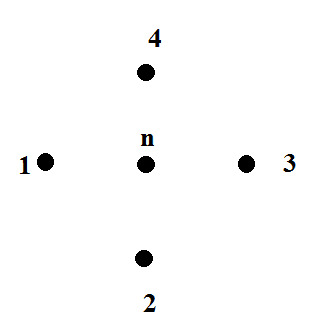

As a final check what would be wrong with using that grid we were discussing. An energy balance in and out of any node would yield:
k(Δy)(T1-Tn)/Δx + 2*pi*k*(T2-Tn)/ln((Rn+Δy)/Rn) + k(Δy)(T3-Tn)/Δx + 2*pi*k*(T4-Tn)/ln(Rn/(Rn-Δy)) = 0
referencing the nodes below, moving from 2 to 4 would be equivalent to moving outward from the cone

I'm a bit surprised by the factors with ln, and a linear expansion gives the same for both nodes in y-direction, where they should be different.
