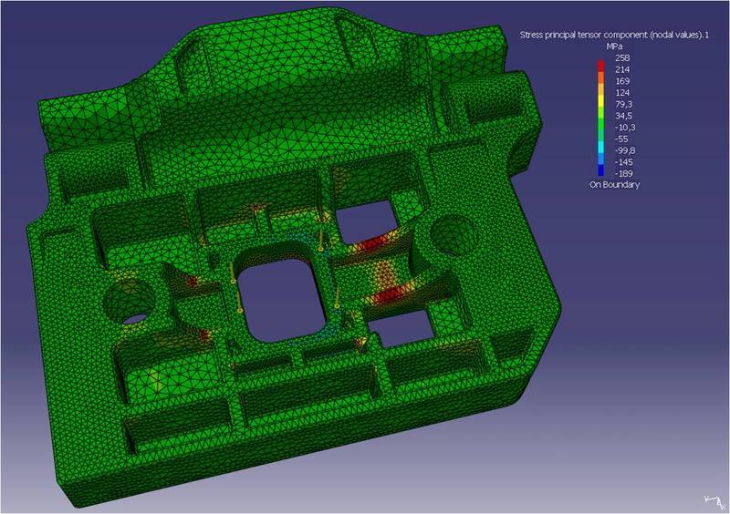

Hello,
I have been following this forum for some time now, but this is the first time I participate. I would appreciate if you could give me a hand in understanding the results of a finite element analysis of an automotive component we have designed.
The analysis results indicate that the stress caused by the load applied is way beyond the material yield strength and even the ultimate tensile strength. The values are 258MPa, 90MPa and 150MPa respectively. This is shown in the first image attached.
Considering this I would assume that not only the part is subjected to permanent deformation but it may also break.

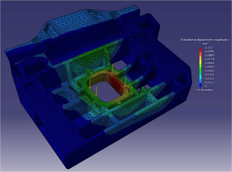

However when I look at the displacement results I notice that the part only buckles 0.1mm. Second image attached. This deformation represents only 0.5% of material elongation. Knowing that the aluminium alloy we are planning to use breaks @2% elongation, does the analysis really show that the component will fail or are we just looking at a hot spot that will not cause any problems?
The part will not be subjected to any cyclic loading.
I would appreciate some feedback. Thanks for reading.

gonzalo75: The strain corresponding to the yield stress is approximately 0.13 %. The analysis indicates that the general stress on the part currently exceeds the material yield strength. It does not appear to be just an insignificant hot spot.
It is better for the general stress on the part to not exceed, nor get near, the yield strength. The analysis is currently telling you that you need to increase the size and/or thickness of some stiffeners. The analysis is also telling you to increase the fillet radii in a few spots.

gonzalo75: Another possible issue is the inefficient shape of the stiffener. The current concave profile of the overstressed stiffener causes material to be missing, where material is needed. If you instead use a straight (not concave) stiffener profile, with only a slight (not rapid) depth taper, then the stiffener might be much more efficient.
What aluminum alloy (and temper) is this? Unless I am misinterpreting, a 2 % rupture strain sounds brittle, in which case stresses greatly exceeding the yield strength might not redistribute well.

The stiffener was originally much more substantial, but it resulted in a stress concentration right at the corner. This was shown in the first analysis we did, which I have attached. Peak stress was then even higher than now. That was when we decided to make the stiffener more progressive to distribute the stress. The resulting stress certainly dropped. But it is still beyond yield.
Part of the problem is that the axial load applied by a bolt is incredibly high. For example, in this case we are using an M10 x 1 (fine thread) bolt. A torque of 10Nm, which is not that high, results in 4800N of axial load! Initially I did a calculation using T = 0.2 D F (D being the bolt diameter. Units in inch and feet) and thought that the result could not be right. Therefore I conducted a test in the lab with a load cell; The theoretical result was only 200N away from the real value.
The aluminium alloy we are using is AlSi12Cu, which is quite common for this kind of application. I also find that a 2% rupture strain is quite low, even more after having tortured a similar part injected with exactly the same material. I have attached a photo in which you may see how much the part buckles without failure. After that the part never recovered, but I was not expecting that much bending without failure.
Having said that, I need to stick to the material properties provided by the manufacturer.

The original design (from post #6) has a very wide scale, so it's difficult to see how far the peak stress actually extends from the corner, though it clearly won't extend very far because of the geometry. Also, that stress is a compressive stress which is a good thing. I'd love to see a printout of the original design using the same scale as the new design. I suspect the amount of material that is actually above yield stress is smaller with the old design when compared to the new design. Being as it's in compression and it's static, and assuming the amount of material above yield in the old design is less than in the new one, I'd think the old design might be better quite honestly. But without knowing how much material is truly above yield, I don't think you can properly compare the two designs.
To reduce stress, I don't think you'll be able to simply change the design of the ribs that are exceeding yield without filling in the hollowed out areas. A higher moment of inertia would help dramatically though, so making the area where the screw goes through thicker (and the ribs taller) would make a dramatic difference. I suspect if you doubled the thickness of the material where the screw goes through, your stresses would drop to well below yield at all locations. The problem may be that the head of the screw then sticks up too far. The solution to that is to get a low head, flat head or button head socket cap screw or similar low profile head screw. The more material you can add under the head to make your part thicker, the lower the stress will be. And the relationship between thickness at that location and stress won't be linear - doubling the height should reduce the stress by approximately 75%.
gonzalo75: I, too, currently think I might prefer the initial design, rather than the second design. In addition to the suggestions by Q_Goest, in the original design, you might want to make the following changes.
(1) Make the fillet radius larger at the stress concentration (where the red hot spot is currently shown in post 6).
(2) Add one stiffener, like the two existing stiffeners, which will give you three stiffeners, instead of two.
(3) Make all three stiffeners substantially thicker than the current stiffener thickness. There is virtually no constraint on stiffener thickness; therefore, you should make all three stiffeners much thicker.​
