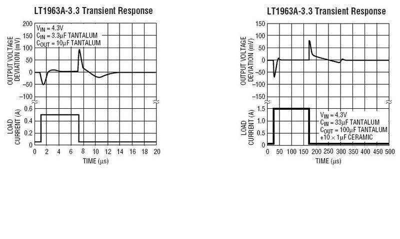

j777
#6
Aug17-07, 11:28 AM
P: 148
The only information that I could find in the datasheet is depicted in the attached image. Would you mind giving an example of how you would calculate the value of an output capacitor given dI/dt?

berkeman
#7
Aug17-07, 02:20 PM
Mentor
berkeman's Avatar
P: 41,087
Those graphs are already showing triensents around 50mV, so the capacitances they list are probably fine for you to start with. Those transients are also almost full scale (off to on), versus starting at 0.5A and having a transient to 1A. An output current transient will generally be handled better by the regulator if it is already conducting a pretty good current before the set up. Be sure to use low ESR caps like the tantalums they mention in the figures.
