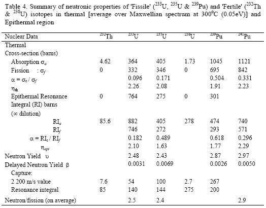

Difficutulties in interpreting data
I'm having some difficulties in interpreting the data on NNDC database. I'm trying to figure out how to use the database.
Ive got a table from IAEA's tecdoc 1450 attached to this message.
Specifically: Table gives data for 233U at 0.05eV:
sigma(f)=332
alfa=sigma(c)/sigma(f)=0.096
Straight forward calculation gives sigma(c)=32, which quite elegantly corresponds to the Sigma Plot of sigma(n,gamma) on NNDC.
But this is not the case in the table, which gives the sigma(c)=54
The second anomaly occurs for when I look at the data for sigma(n, total fission) at NNDC's site, which gives the value 377. In the table this value is 332 as earlier described.
Anyone got a hunch what errors I may be making?
sigma(f)=332
I don't see your problem: the absorption is 364, of which there is 332 fission, so there is 32 capture in the table, no ?
Also, these values are INTEGRATED values over a thermal SPECTRUM at 300 degrees (corresponding to about 0.05 eV average), but 32 is actually pretty close to the cross section in the table at 0.05 eV if you check, while 54 is the value at one single energy (0.0253 eV).
2200 m/s corresponds to 0.0253 eV.
I've checked this, and I don't know either why this is so. Maybe the cross section is not strictly 1/nu and the maxwell integral doesn't give the same as the value at the average energy...
