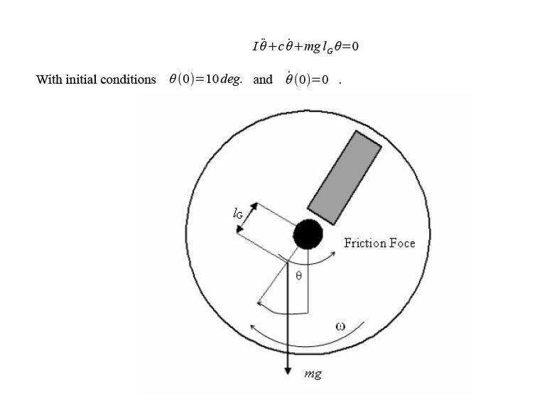

second order ODE solution for this system??
hello guys,
I am wondering if what is the analytical solution for this system?
can we solve it as a mass-spring-damper system?
thanks for your helps.
the rectangular part is removed from the disk.

So the DE is
ax'' + bx' + cx = 0
Write the characteristic equation...
an^2 + bn + c = 0
Solve for n using the quadratic formula...
n = [-b +- sqrt(b^2 - 4ac)] / 2a
This will give you two (possibly non-unique) exponents. if the exponents are different, say n1 and n2, then the solution is
x(t) = Aexp(n1 t) + Bexp(n2 t)
If the exponents are the same, then
x(t) = Aexp(n t) + B t exp(n t)
Am I missing something, or does this answer your question?
thanks a lot, that is the answer if the motion is linear, how about the angular motion?
how can i modify this equation.??
To make it angular, rewrite it using "theta" instead of "x".
