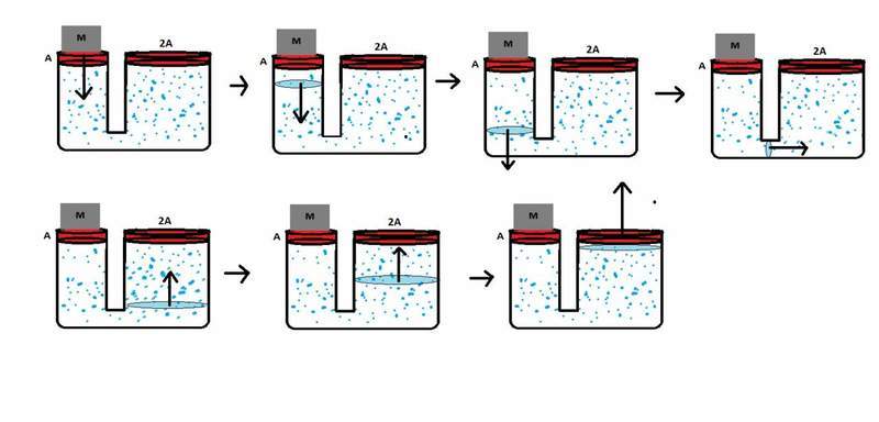

THAT'S AN ENERGY OBSERVATION! I want to understand it purely in terms of forces. Okay, maybe I'm not making sense so I tried to draw a model of what I think happens in the fluid, and I'll describe how it is to be interpreted. Then you can tell me what it wrong.
So my notion of all this is that when you apply a force at one piston, here at the one with area A, it will try to move down but bump into the top layer of particles which will slow down the piston. This layer will now try to move down but bump into the next layer and so forth until we reach the other piston, which will move upwards if there isn't any force pressing down on it.
See my drawing, I really tried to make it easy to understand what I mean this time. Do note that the force vectors should all be of equal length.
Now, as you can see nowhere in this notion of what happens would a force twice as big on the layer just before signal reaches the other piston appear. So obviously it's wrong - I JUST DONT UNDERSTAND WHY.
Another thing that's wrong about it, is that if you don't apply a force to the other piston it would just keep moving on and on etc...
So yes, I am wrong, but please please try to explain what fundamentally is wrong about my assumptions :( I wouldn't mind a 2 page answer at all, because I'm wrong about the basics of this.
Is it?
I would have said it is a continuity observation.
When I presented the energy argument for your earlier example I said that the volume of fluid moved out of one chamber must equal the volume moved into the second one.
This is the key fact that connects both chambers or both ends of a hydraulic system.
Since the volume does not alter it follows that if the cross section area changes the length or distance must change to compensate.
This principal is known as the equation of continuity and is hidden in many physical processes.

Exactly! You finally get my question! :)
But, problem with this is that it is far more complex to understand in forces than just to apply an energy observation - that doesn't however change the fact that I do want to see what happens in terms of forces. And while not so intuitive to me I know, that there is no law of conservation of net force.
To show that I really do understand this, look at the picture. The second mass is being acted on by twice the force, because of the string arrangement. But conservation of energy is still not violated, because when the masses move it will have to travel twice the distance as the other.
I just want the same force intuition for the hydraulic pump.

I'm just still not quite sure - can you try to explain what's wrong with my model in post #21?
zezima1 said:
Okay I think I may get what you mean - pressure is something that also connects to statistics, i.e. the force will not concentrate on a single point but rather spread out over the entire volume.
Pressure is a force density, force per area. Your areas are changing. In your post #21 remember that the number of particles interacting with the surfaces is proportional to area.
The other thing with that model is that the forces aren't just turned around, they continue to push down when they start pushing down. They also make the fluid want to expand sideways so the walls impart a force but the forces from the left walls cancel with the forces from the right walls. The pressure forces from the floor cancel with the forces from both pistons. Imagine the whole device on a scale. You push down on A1 with F1 and A2 with F2 and the scale will read F1+F2 as it is the SCALE pushing upward on each area of the two pistons through the walls and the fluid.
Try it with the pistons in line, like the ones in your first diagram. The walls push inward and since the area increases some of that inward will be angled toward the bigger area. It geometrically must add up that way and you will get a net force in the direction of the bigger area proportional to the pressure times change in area.
Note this is how a jet or rocket works. The walls push the fluid back and the fluid push the walls forward along with the rest of the rocket.Finally it may help to consider extreme cases. Imagine the area of the smaller piston approaching zero. You then have basically a gun barrel with the "big" piston being your bullet. Try to see from where the force accelerating the bullet originates... why do guns recoil?
I really liked this part. Does something similar happen when the pistons are not in line but like in the picture in post #21?
  • #31
Yes. If you want to calculate it in full glory, you can carry out a surface integral of pressure times inward normal to the surface. This gives the net force on the fluid. I in integrating you leave out the pistons then this total force must equal the forces on the pistons.
