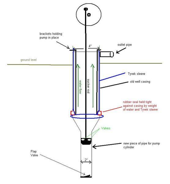

I'm designing a bucket pump for a water well I'll be attaching a pumpjack to. I'm just a regular shop guy so I was kind of stumped on a question of how much upward pressure will be required to move the water up the drop pipe. If the pump cylinder is the same diameter of the drop pipe I figure I'll need to move the entire weight of the water in the pipe BUT I plan to have the cylinder actually only about half the diameter of the drop pipe. My question is if I have a 2 inch pump cylinder (2 feet long) tapering out/upward to a 4 inch drop pipe will I need to ad the weight of the water in the cylinder to the entire weight of the water in the 4 inch drop pipe? I'm not a physics guy so I wasn't sure if there is some law here I don't know about to figure this one out. Would the entire weight of the 4 inch drop pipe water no longer be needed to move it upward since the pump cylinder was more narrow? Thanks for you help in advance.

The weight working on the piston is proportional to the area of the piston. It does not matter how much larger or smaller the pipe leaving the piston chamber is.

Soooo, if you have a 100 foot well with a 2 inch piston for an area of 3.1415 square inches, plug the numbers in. Specific gravity of water is 1, so it is 43.4 PSI. A piston with an area of 3.1415 square inches gets you 136.3411 LBS that the piston has to lift. Of course this is only the water, you need to lift the pump rod too.

So the weight of the 4 inch wide column of water (100 ft. tall) in the drop pipe isn't creating downward pressure on the piston? The piston pushing the 2 inch cylinder of water into the 4 inch drop pipe above only has to move the weight of the 2 inch portion? There is no check valve between the 2 inch cylinder and 4 inch pipe. I've attached (I think) a crude drawing of what I'm planning.
I think you have the idea correct , even if the words are imprecise.
Looking at your picture in post #3
FORCE on piston is pressure X its area.
This is exact same principle as the hydraulic jack you use to lift a truck.
Lifting the piston does lift the whole column of water
but as water moves from skinny section to fat section it spreads out
so one inch of upward travel at piston gives less than one inch of upward travel in fat section of pipe, where there's more cubic inches per foot of pipe.
That's "mechanical advantage".
think of it this way
consider the water in wide section of pipe as a piston instead of water
and FORCE = PRESSURE X AREA
use small FORCE on small-area piston to apply larger FORCE to large-area piston above.
Force on your small piston in pounds is:
its area(in square feet) X height of water(in feet) X 62.4 pounds
only trouble i see is roughness of the old pipe - can you get a seal betwen pipe wall and piston?

The pump cylinder will be new pipe. The seal will have to be where the tapered portion intersects with the old well casing. The gasket will be like a 2 wide rubber belt pushed up against the old well casing by the weight of the water and Tyvek sleeve. I added a few more things to the diagram to hopefully explain it.
