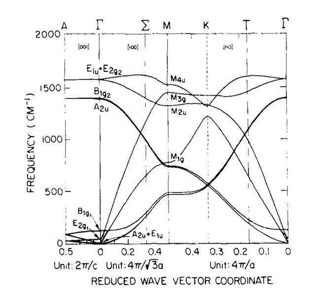

Hmm I'm not quit sure I understand. I have the vibrational modes
Vibration = 2 * E1u + 2 * E2g + 2 * A2u + 2 * B1g
Summing the dimensions I get 12 modes, I guess that must be 9 optical and 3 acoustic modes (4 atoms per unit cell should give 12 modes), so to me it seems like the acoustic modes are included.
I have attached a dispersion relation for graphite, it seems like on that picture that one have
Optical = E1u + 2*E2g + 2*B1g + A2u
Acoustic = E1u + A2u
Adding these one gets my result. Could it be that because graphite is non-symmorphic space group it is one of the special cases where A1g is not the ground state but rather E1u or A2u is the ground state? Or is it still because the theory only describes the system with one quanta of energy and thus the list does not include the ground state A1g, even though it seems like the acoustic branches are included in my list?

Well, that is correct, translations of the crystal in plane (x y) transform like E1u and along z like A2u. However, they aren't vibrations in the strict sense.

Is it then one of these that are the ground state (E1u + A2u aproaches zero energy, so i guess one of them are), or is it still A1g?
If it is one of them, which is it I should use to calculate if a given transition is raman active, and why?
If they are not, how come the ground state is not included in the allowed vibrational modes? I seem to fail to see where the symmetry analysis exclude the ground state of the analysis, if this is the case?
