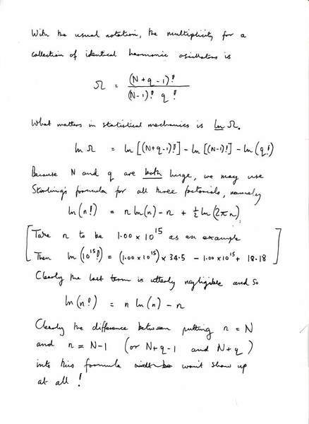

See attached sheet for more detail.

hmm... I definately must be making some kind of basic mistake, because I can't get the approximation to make sense. So let us try to do it for two large numbers for q and N and you can point out what I do wrong:
We have:
Ωreal = (q+N-1)!/((N-1)!*q!)
Ωapprox = (q+N)!/(N!*q!)
Let N=1023and q=10100. These are both large numbers with q>>N.
Now plug in to the two expressions:
Ωreal = (10100+1023-1)!/((1023-1)!*10100!)
Ωapprox = (10100+1023)!/((1023)!*10100!) = 10100/1023 * (10100+1023-1)!/((1023-1)!*10100!) = 1077 * Ωreal
How is this factor just a negligible term? And what has this term got to do with the reason ""The ratio of N! to (N-1)! is only a large factor (N).", which is how the author of my book defends the approximation..?
