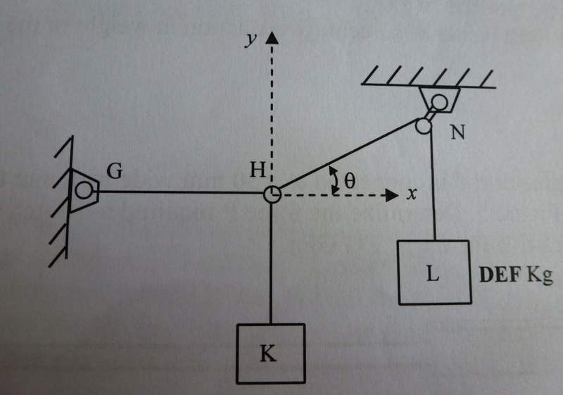

1. The problem statement, all variables and given/known data
can anyone show me what the free body diagram of this would look like?
Thankyou

For which body do you want the Free Body Diagram? ... mass K, mass L, the pulley at N, or the junction of the cables at H
Apr15-12, 12:31 PM   #3
well the question asks me to work out the mass of K
Apr15-12, 12:46 PM   #4

There are three forces acting at H. First there is a horizontal force acting toward point G. Second, there is a vertical force due to the weight of K. Third there is a force toward point N. The magnitude of the downward force is, of course, mg. The magnitude of the force toward N is the same as the weight of the mass at L. Decompose the force toward N into its horizontal and vertical components.
