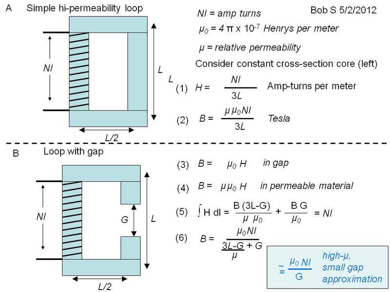

I am curious to know, why on a electromagnet that the wire coming in is on the opposite side to the wire leaving?
Is it due to the way the current comes in and leaves, as in the anticlockwise field in the north so incoming and the outgoing is clockwise south.
When I say a electromagnet I mean a bar and horseshoe.
Where the wire joins and leaves the coil is arbitrary, as long as as you have one continual coil (no cut anywhere breaking the circuit) and each coil loop turns the same way around the core. The current that adds the most to the magnetic field is the current through each loop in the coil, not the current through the wires that connect the coil to the battery.

Here in attachment is a drawing of a basic horseshoe electromagnet showing a single coil of N turns carrying I amps, and the equation for calculating the magnetic field B Tesla in the air gap.
