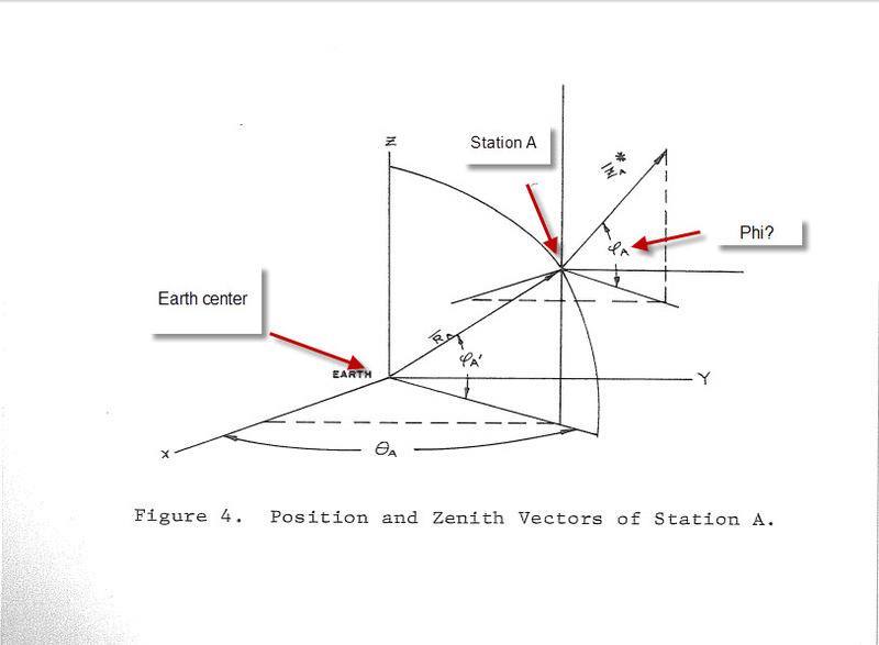

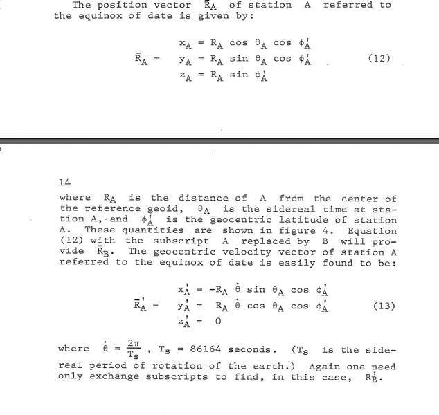

I'm looking at a book on meteor calculations involving at two earth stations, A and B. The computations for A are given, and the same for B. I would like to know a reference for equations 12, 13, and 14. Even a derivation.
I find figure 4 a bit puzzling. The text uses lower case phi, a vertical line with a circle in the middle, but the figure shows what is perhaps a capital phi. A looping curve. I'm guessing this is meant to be former symbol, vertical + circle,
Secondly, it looks like the x,y,z axes for the topo system should be labeled with a prime on x,y,z.
Thirdly, the two phi's look like they should have the primes swapped.
Comments on my remarks?

The symbols [itex] \phi[/itex] and [itex]\varphi [/itex] are just two different ways of writing lowercase phi.
For a derivation of equation 12, see this diagram here:
http://en.wikipedia.org/wiki/File:3D_Spherical.svg
How to get the Cartesian coordinates (x,y,z) of the point in terms of its spherical coordinates (r,θ,ϕ)?
It's clear from the geometry that the z-coordinate of the point is just given by z = rcosθ. (Just take the position vector of the point and project it onto the z-axis). EDIT: or just look at the right triangle formed by the dashed lines.
The magnitude of the projection of the position vector onto the xy-plane is just rsinθ. It's the other side of the (dashed) right triangle that we used above to get the component of the vector that was parallel to the z-axis. So it's the dashed line on the xy-plane in the figure.
Now, take this *projected* vector and further resolve IT into an x-component and a y-component on the plane. The x-component will be given by the projected vector multiplied by the cosine of the angle between that vector and the x-axis:
x = (rsinθ)cosϕ
Similarly:
y = (rsinθ)sinϕ
Again, you get these by drawing the appropriate right triangle on the plane (not shown).
EDIT: The meanings of theta and phi are SWITCHED in my figure compared to yours. Sorry for any confusion. Mathematicians and physicists often use the opposite symbols for these two angles.

I gave you the derivation for 12 in my previous post. Equation 13 is just obtained by differentiating equation 12 with respect to time, and using the chain rule. The equation makes perfect sense if you assume that [itex]\phi_A^\prime [/itex] is constant i.e. it does not vary with time. This makes sense since it is supposed to be the latitude of the station, which is fixed.

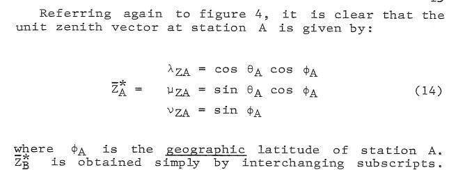

Equation 14 is just the same as equation 12, except in the station's coordinate system. Also, every component has been divided by the total length of the vector ("R") since this is meant to be a UNIT vector in the direction of the zenith. That's why 14 looks like 12, but without the radius as a coefficient on each term.
Quote Quote by solarblast View Post
I'm sorry, I don't know what you mean here.
Not from what I can see in the text. It says that [itex] \phi_A^\prime[/itex] is the latitude of station A as measured relative to the centre of the Earth, and that is reflected in the diagram.

Thanks very much. That was almost too easy now that I look at it, but what threw me off was the primes, and the fact that ϕ′A was a constant. That plus mention of the word equinox, which suggested some deeper meaning than I could see.
I think the use of primes was different than I expected. When I used topo, I was thinking the coordinate system at the surface of the earth should have been marked with a prime (x',y',z'). I think the case here is the author used ϕ′A to distinguish it from ϕA.
Regarding (14), then this seems to me that is the same transformation applied as (12), as you say, to the topo (station) system, but ϕA' is replaced by ϕA. It is further modified to make it a unit vector. In other words, the transform is applicable to either system.

Yes, of course it's applicable in both cases. It's a general transformation between a spherical and a related Cartesian coordinate system. The way the two systems are related is that the z-axis is a line passing between the two poles of the spherical system, and the x and y axes lie in the equatorial plane of the spherical system.
