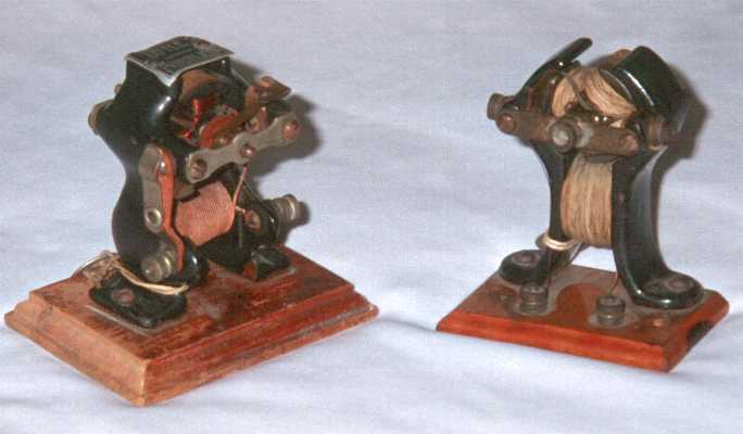

Only the very simplest dc motors, like the ones found in high school physics labs,and usually are not self starting, have two poles. Even the simple toy electric motors in the 1896 Sears catalog or 1894 Montgomery Wards catalog (e.g., Little Hustler-see pic) had 3 poles and 3 pads. Modern dc motors have 20 or more pads, so the cosθ pulsation effect is minimal. Also, because of the inductance of the rotor windings, the current variation due to using a switching regulator as a current source is minimal. There is no back emf if the current pulsing is minimal or if the rotor is locked.
added There is back emf when the rotor is turning.
