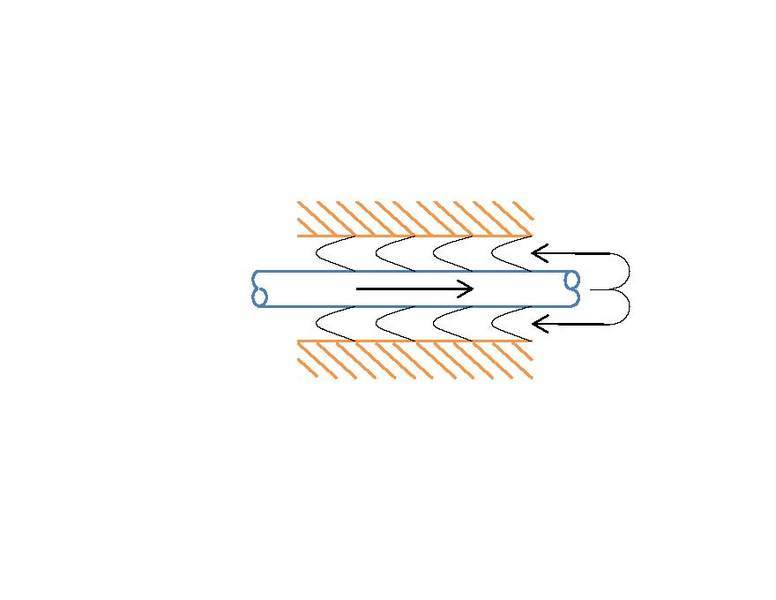

I have a pressure flow problem where I'm trying to understand the velocity profile of a fluid in an annular space between a stationary exterior cylinder and a rotating, longitudinally advancing cylinder at its center.
So the boundary conditions a zero velocity at the exterior surface and a constant angular and longitudinal velocity at the interior surface.

Jun6-12, 08:16 AM   #5
That's the standard solution for steady-state, pressure driven flow in a stationary pipe. In this case we have two boundary layers. In the attached image, I'm trying to solve for the velocity profile between the two boundary layers, where the outer (brown) layer is stationary, and the inner (blue pipe) layer is moving to the right and rotating.

Jun9-12, 04:01 PM   #6
I think what you are describing is Taylor-Couette flow. For very low rotational speeds it has a known solution (like V=Ar+B/r, where A and B depend on radius and rotational speed), but it quickly becomes difficult to get analytic solutions.
