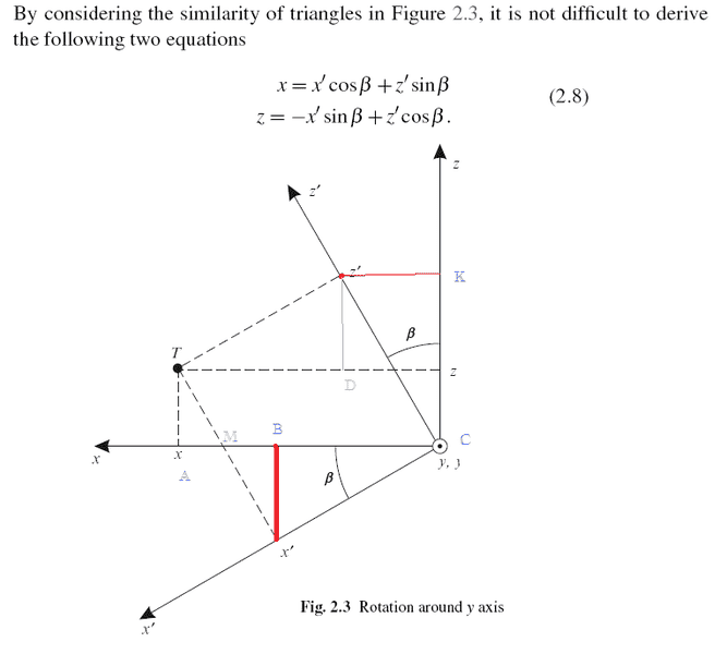

Here the writer on 11th page writes:
"By considering the similarity of triangles in Figure 2.3, it is not difficult to derive
the following two equations
x...."
where I can't get which triangles to look for similarities as there could be various (I'm no expert in math) and also, can't get how the formula is derived. Please explain
screen shot of book:
i46.tinypic.com/30i9nih.png
Thank you in advance

look at the attachment, I have added new points and lines to your picture to make the proof clear.
We have:
x= AB+BC
but BC = x' cos (beta)
and AB = TM sin beta + Mx' sin beta
= (TM+Mx') sin beta
= Tx' sin(beta)
= z' sin (beta) (because Tx' parallel to z')
hence x= x' cos beta + z' sin beta
Similarly,
z = CK -zK
but CK= z' cos(beta)
and zK= z'D= Tz'sin(beta)= x' sin(beta)
hence
z= z'cos beta - (x'sin beta)

Quote by Quantumjump View Post
Thanks you very much! Now I understand it clearly!
