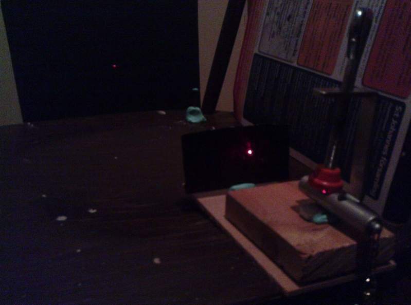

Hi! A cloud chamber would certainly be cool. Otherwise there's of course also the famous double-slit experiment, it's quite easy to do today. As a matter of fact, I experimented with this some months ago at home for fun, trying to get the best result with minimal equipment. I was thinking of writing a short guide on this actually, but I haven't done it yet. But here's what you would need:
1. A laser
2. Slits
3. A screen
Some notes on the way:
I used a small pen laser (at first with the power button pressed down by tape or something, but later I disassembled the laser and used an external power supply and a power switch).
There are a number of ways to construct slits; I have tried these (and I preferred option 2):
1. Razorblades and aluminium foil. Paint the aluminium foil black with e.g. spray paint. Glue/tape two razorblades together and cut two parallel slits in the aluminium foil (actually make a number of slit setups, since it's quite easy to tear apart the foil). This is however not the solution I preferred, it's a little tricky and easy to mess up.
2. One "barrier" is equivalent to two slits with infinite width. So you can get an interference pattern by using just a single thin barrier. You can use a hair (40-120 μm) taped up on some frame (I used old dia slides). You can also use a thin copper wire extracted from an electrical wire (paint it black). You can actually also use a lead for mechanical pencils; I tried with a 0.5 mm lead and managed to get a pattern nevertheless. But thinner barriers are better; I preferred hair or copper wire.
3. You can also take one or a couple of needles, paint them black and tape them together. But I prefer option 2.
4. Reflection from a laser via a CD is also supposed to show an interference pattern. I've tried this, but got pretty strange patterns which I found difficult to interpret.
5. You could also buy a slit setup from some science shop.
There are some other issues to address as well; laser targeting, environment lighting and screen distance. It's a little tricky to point the laser perfectly at the slits, so some smart mechanical setup is recommended. The laser can be fixated with e.g. tape or something, but I actually used a small adjustable Lego Technic construction I built for this purpose :). Further, in a bright room the interference pattern can be hard to distinguish. One solution is to "screen off" the screen, e.g. tape up a screen inside a cardboard box or something (the screen can be a simple white paper). And last, the distance from slits to screen will determine the pattern resolution (longer distance->wider pattern). I got the best result with the screen at about 4 meters from the slits. If the screen is too far away, I found the pattern to get too blurry.

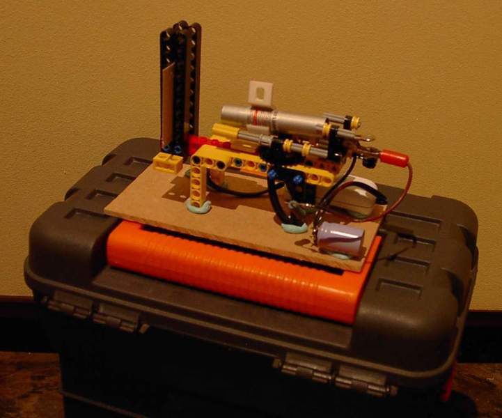

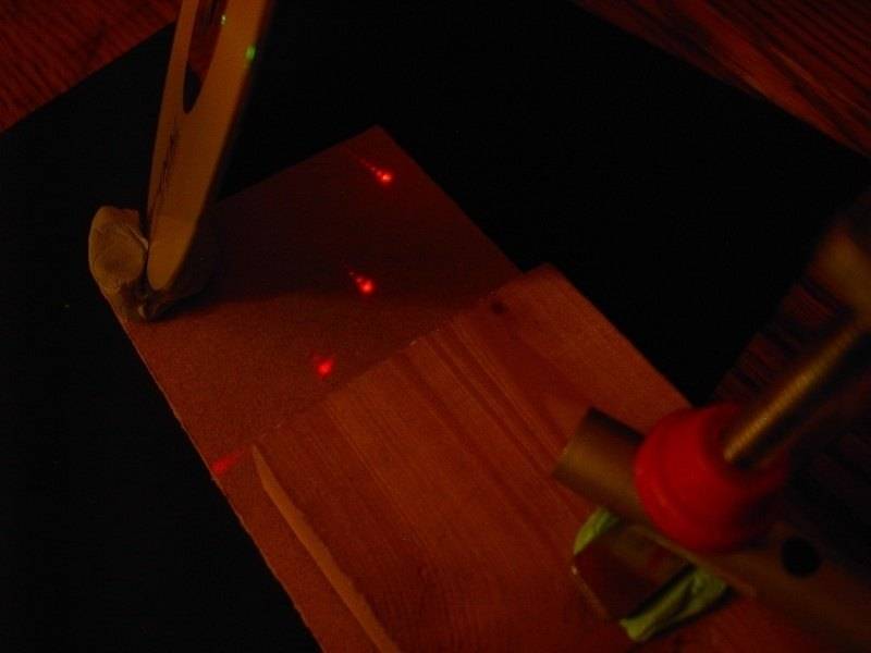

I attach some pics from my experiment (I apologize for a lousy camera used by a mediocre photographer);
1. My first crappy setup (but it worked).
2. An adjustable Lego Technic laser cannon.

5. Pattern (?) from a CD (I can't really interpret that one ).

AWESOME SUGGESTION! how much did it cost you? and how much time did it consumed for you to make one?
Jun28-12, 04:32 AM   #11
Blog Entries: 8
Hi, I'm glad you liked it! The first crappy setup cost me nothing, as I already had the necessary stuff at home. And that setup took me an hour or so (incl. doing slits). I have done the experiment many years before with professional equipment at university, so I already had some experience.
Pen lasers are cheap; 10$ or so (the laser I used is a cheap, crappy one). If you have nothing at all to start with, I think you can make it with less than 20$ (laser, slits, tape/Blu-Tack, tools).
A friend of mine got the idea that Lego Technic could be useful for this purpose. I bought a Lego Technic Crawler Crane (9391) for about 20$ and tried to build an adjustable laser device out of it. But this took me some time though, since I had to figure out a workable design. It took me probably four hours or so (experimenting, building).
In order to connect an external power supply to a pen laser, you'll need some tools (soldering) and basic electronics knowledge. I used a 4,5 V/300 mA adapter + one capacitor (220 μF, 50V) in parallel (for extra voltage stabilization) and a 330 Ω resistor in series (to get a proper current) + a power switch. This took me about an hour or so. But, depending on the laser and the adapter, this can take some time and experimenting in order to get a good voltage/current (not too high, not too low); the brightness and quality of the laser light is very dependent on this.
