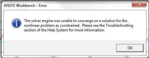

Hi,
I am trying to analyze the effects of pressure on the automotive t=ire by modeling and simulating the same in ANSYS workbench. However, I am having trouble applying material conditions to the model.
I wish to use mooney rivlin material but when I apply that based on the guidance given by the following link, my solution does not converge.
video link: http://www.youtube.com/watch?v=Kt-AbUrxV1g
My boundary conditions are fine because if I use a material such as steel, I get a solution.
Kindly help me and let me know where I could go wrong.

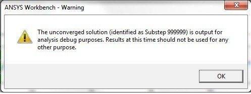

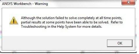

amanmahajan
amanmahajan is offline
#6
Nov8-12, 10:44 AM
P: 17
Following are the error messages that I obtained:
substeps:
initial: 20
minimum: 10
maximum: 100

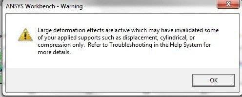

amanmahajan
#7
Nov8-12, 10:45 AM
P: 17
two more errors continued.
Mech_Engineer
Mech_Engineer is offline
#8
Nov8-12, 12:41 PM
Sci Advisor
PF Gold
Mech_Engineer's Avatar
P: 2,234
  • What does the force convergence chart look like, was it slowly converging or bouncing all over the place?
  • Are you sure that your model is fully constrained? Does the deflection look something like you're expecting or is it mainly solid body movement?
  • Are you applying a contact condition on the bottom of the tire? What properties are you applying to that boundary?
