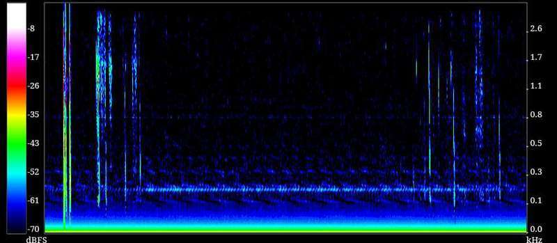

So periodically (every few months, for a few days or a week) I will hear an annoying humming noise at home. It is worst at night, probably because the air is still outside and noise transmits better - and there is less ambient noise. It sometimes rises and falls, sometimes seems to pulse, but it is always exactly the same frequency (about 200 hz). I know it is real and not in my head because I captured it on my phone's spectrum analyzer ap (photo attached -- how cool is that ap?) and it is definitely coming from the window.
I'm about 5 miles from the Limerick nuclear power plant, so I'm wondering if I'm hearing a bearing fail on a generator.
Normally, this would just be a curiosity, but I think it is contributing to the trouble I've been having sleeping this week. I lie in bed, fixated on the sound.
Anyway, mostly just venting, but I wonder if I could build myself an active noise cancellation system or soundproof my window or something.

Not being able to sleep drives me crazy. Are you getting the highest frequencies by the window? That ap is pretty slick. When I worked nights, I used noise reducing blackout drapes. It was like a big heavy x-ray coat to go over your window with magnetic strips for the edges. Another inexpensive option is a box fan. Fans have been the best enhancer sleep in my experience.

There is only one frequency. It is just louder by the window.

I wonder if the vibration is a transformer or motor somewhere nearby. Is there an electrical substation nearby?
We used to have a sewage pump station nearby (~0.2 miles), and one of the motors made an irritating humming (almost grinding) sound. It was especially noticeable at night, and particularly with the windows open.
On a piece of turbomachinery, it could be a bearing on its way to failure, or shaft vibration.

Can you hear it if you go outside? It might be amplified by a resonance coinciding with the dimensions of the room.
In my house, there is a 12V transformer for the doorbell mounted on one side of a wall, and in the room on the other side of the wall there is a very distinct mains frequency hum audible at one place in the center of the room, but nowhere else in the room. Since switching off the transformer stops the sound, the source is obvious, but it's a nice demonstration of how little energy is needed to produce a sound.
I would be a bit surprised if a sound at 200Hz carried for 5 miles. It could be a nearby house using a washing machine overnight on cheap rate electricity, or something similar.

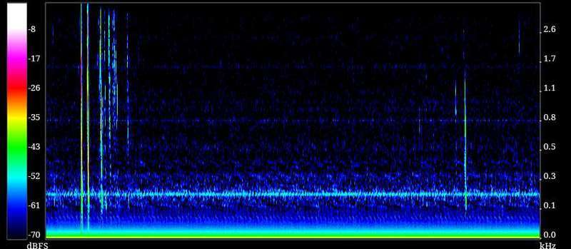

I found the source. There is a small medical device manufacturer .4 miles from my house, along the same line of sight as the nuclear plant (which is actually 6 miles according to Google Earth. It is a piece of rooftop HVAC equipment. I pulled into their parking lot, turned-off my car engine and checked the spectrum analyzer again (attached). Must be a wind issue or something, because it isn't audible during the day, only on certain nights.
God damn HVAC systems! Yeah, it will probably be a combination of lower background noise levels at night (as you mention in your OP), and varying meteorological conditions. Do you plan do take any action to deal with this, or now you know the source of the problem will that help you sleep at night? (so to speak).

When there's warm air above cooler sound gets channelled, almost as in a waveguide.
That explains your nighttime/daytime disparity. It's real noticeable in my neighborhood , about a mile from railroad tracks.
I'd wager a hand written letter to the manager at the plant, with an offer to help track down the source, would be well received. It's likely a resonance in some sheet metal skin of the HVAC unit and fixable with an automotive sound deadening spray-on product.
Most folks in industry want to be good neighbors...

Could be but I'd guess the variation is due to changes in the resonance frequency of one or both structures (HVAC on building, Russ's house-window) from temperature changes causing expansion-contraction.
