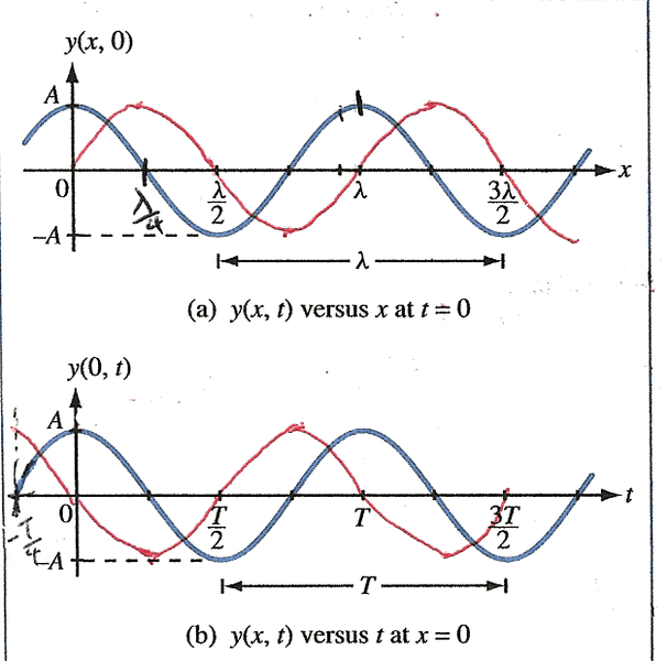

A sine wave traveling in +x direction can be represented by [itex]\cos(\omega {t}- kx+\phi)[/itex].
As shown in the drawing attached where [itex]\phi=\frac{\pi}{2}[/itex]:
a) Is a plot that holds t=0 and two waves along +x direction.
[tex]t=0\Rightarrow\; \cos(\omega {t}- kx+\phi)\;=\;\cos(- kx+\frac{\pi}{2})[/tex]
This implies maximum at [itex]-kx+\frac{\pi}{2}\;=\;0[/itex]
[tex]k=\frac{2\pi}{\lambda}\;\Rightarrow\; \frac {2\pi}{\lambda}x=\frac {\pi}{2}\;\Rightarrow\;x=\frac{\lambda}{4}[/tex]
This gives the wave form in RED that LAGs the [itex]\cos(\omega{t}-kx)[/itex].
b) Is a plot of the waveform at x=0 and the two waves vary with time t.
[tex]x=0\;\Rightarrow\; \cos(\omega {t}- kx+\phi)\;=\;\cos(\omega{t}+\frac{\pi}{2})[/tex]
This implies maximum at [itex]\omega{t}=-\frac{\pi}{2}[/itex]
[tex]\omega{t}\;=\;\frac{2\pi}{T}t\;=\;-\frac{\pi}{2}\;\Rightarrow\;t=-\frac{T}{4}[/tex]
This means waveform in RED LEADs the original wave.
So the two cases give opposite result. Can anyone explain this to me?
Thanks
Alan

Lead means a given wave peaks before the referenced wave so in your case the red wave peaks before the blue wave in time.
Lag means the blue reference wave peaks and then the red wave peaks at a later time.
Thanks for the reply. But both cases comes from the exact same equation where [itex]\phi=+\frac{\pi}{2}[/itex]. How do you justify one is lead and one is lag depends on what reference used?
The other more basic question, Am I interpreting these correctly? It is very confusing.

I think they're basing it on the phase angle so a positive phase angle means the wave lags behind a wave of phase angle 0 and conversely a negative phase angle leads.
In the first example, they're looking at waves where t is fixed at time zero.
In the second example, they're looking at the same two waves where x position is fixed at 0 and the waves vary in time.
The reference wave is the one with phase angle 0.
I don't think I'm being very helpful here but I trying...
Thanks 0xDEADBEEF, I understand this. My question is why the ∅ is lag ( to the right) in a) and lead ( to the left) in b)?
I can even see why the phase is shifting to the left when holding x=0 and change t. I have no issue of understanding that either. Problem is the book called this as LEAD. That is where all the confusion started.
In my understanding, a +ve ∅ ALWAYS imply lagging no matter what!

Ok I think I see your point now. Sorry if I was too pedagogic. The name lead is indeed ****. The curve is located further to the left, this means it will arrive later at the point of observation. It is in no way leading. But I am just a physicist, maybe this naming makes sense in someone else's world.

How would you draw the conclusion that the red curve lags, from a plot versus distance?
Think about this and you'll see (maybe) why are you confused.
The red is leading in both "cases". There are not two cases actually. You are just miss-interpreting the first plot.
By the way, leading and lagging are relative for continuous waves. The red is leading by T/4 or lagging by 3T/4.
Usually the least distance in time is considered. So here they would rather say is leading by T/4 rather than lagging by 3T/4.

You are still confused.
The first plot is for a given, fixed time. To say "until x=λ/4" does not make sense.
The point x=λ/4 exist at all times.
What you see there is like a snapshot. The leading wave is the one that is, well, ahead.
If you put a detector at some position along that line and let the time run, the red wave will reach the detector first*. The whole figure will shift to the right as the time passes with the red peaks remaining ahead (in space) of the blue ones by λ/4
*Unless you put it right between a blue and a red peak.

At this point, the more important question is whether I am correct with my drawing that [itex]\cos(-kx+\frac{\pi}{2})[/itex] is the way I draw it in red in the top graph with x axis?
