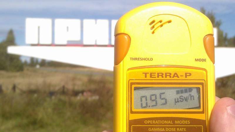

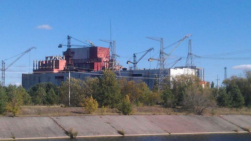

As far as I know, reactors #1, #2, and #3 still have some fuel contained within, as well as some in the spent fuel ponds. Over the years, a number of proposed contracts for defueling and transportation of the spent fuel to a long term storage facility have fallen through due to budgets overrunning and the difficulty in dealing with the politics of the region (Western companies tend to have a hard time overcoming the bureaucracy, as Ukraine likes to appear to be pro-Russian rather than pro-Western).
Recently there's been an increase in pressure from the IAEA as well as the Chernobyl-Fukushima human interest group to completely decommission the site. From what I understand, the current plan is to finish the previous abandoned ISF-2 storage site after the Sarchophagus replacement, and then defuel 1 - 3 (no idea how they will attempt to decommission number 4 though!).
That's an awesome picture btw, here's one of the scrapped reactors 5 and 6 I took whilst I was there, complete with cranes and half-finished buildings where construction was suddenly halted. Spooky!

Love that pic.

Well they in the process of building a replacement sarcophagus to fit over the rather hastily built one. It is being built on-site, just a few hundred yards form reactor #4, constructed on rails so it will simply 'slide' over the old structure. In the last couple of months they announced that the first stage had been completed, the basic frame of the sarchophagus mk 2 now up. The company in charge is called 'Novarka' (google 'em to see some sarchophagus pics, it's pretty cool!).
The final plan will probably be a combination of both your suggested ideas. Using radiation-resistant robots to try and clear away as much of the fuel and high-level waste as possible, the last stage will probably be to use concrete and seal the building completely. This could in all probability decrease the dose rate outside the building to around background levels! At the moment the dose rate in the air close to the NPP is around 0.9 μSv/hr (about 3 times normal background). That's mainly due to the reactor itself. The dose rate on the ground is higher in places (hot spots due to contamination from the explosion and the cloud). See a couple more pics to highlight this.
I wouldn't say that Chernobyl is old hat, at least not to the international nuclear community and to the people of Ukraine. I also don't know who said that the Fukushima exclusion zone is more 'dangerous' or 'hotter' than the Chernobyl one, but let's just agree that qualitative and emotive expressions like these don't really have any place in a scientific discussion ;).
Since the CNPP exclusion zone is actually a hive of activity (about 3,000 scientists and engineers living there), as well as being home to some 300 settlers who have moved back in (oh and don't forget the Chernobly national park, a wildlife haven for animals), it's certainly not as bad as you make out. You don't need protective clothing or respirators, and in most place the dose rate is actually LOWER than in cities, since you don't get nearly the same amount of traffic.
The only comparison I can make between Fukushima and Chernobyl that is related to your original question is that much of the same robotic technology and containment procedures will be applied between the two. There's a great deal of scientific collaboration in this regard.

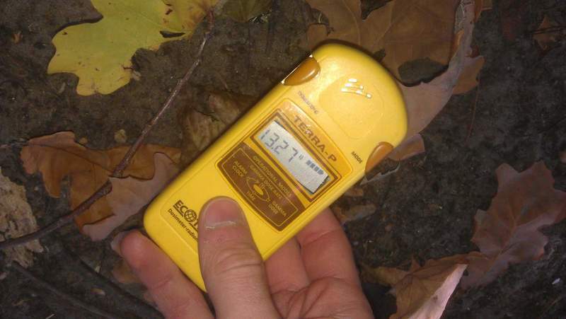

The Chernobyl exclusion zone is a bustling haven for variously environmental and scientific research. It would probably be a better decision to just build a secondary sarcophagus to reduce radiation levels in Pripyat and surrounding areas to normal background levels.
The only place in Chernobyl that has DANGEROUS levels of radiation is inside the reactor block itself. All of the nuclear fuel is contained entirely inside the sarcophagus and poses no environmental threat.

Quote Quote by Kutt View Post
I posted a picture above that showed a gamma dose rate on a soil hotspot of 13.27 μSv/hr. The nuclear industry considers this a 'dangerous level'. Whilst much of the exclusion zone is low in dose rate, these hotspots are what make the area unsafe (from a radiological point of view, there are other dangers).
