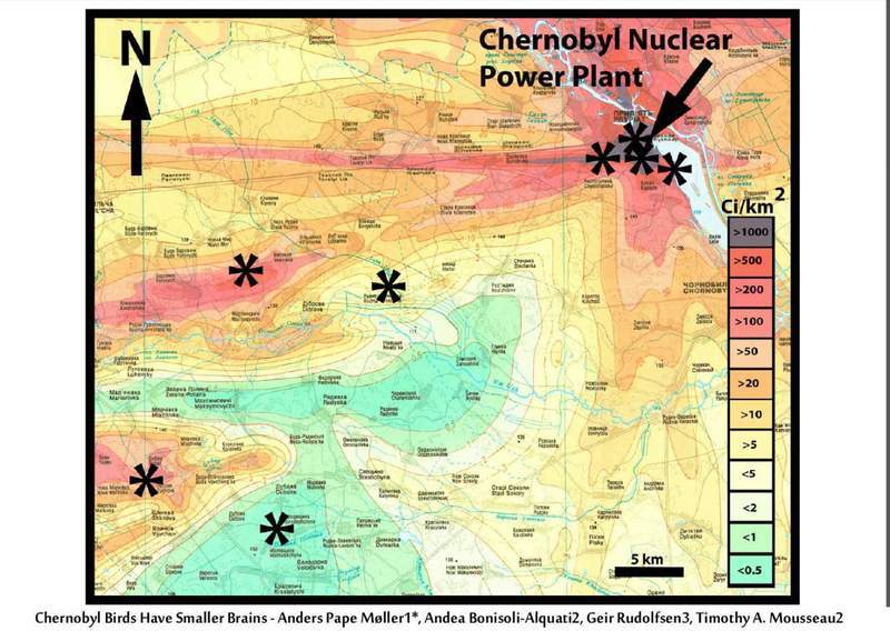

regarding the radiation level, I'm interested to find out the level around the red forest. Do you have any idea where I can gain such information? It would actually be really interesting to see the change in radiation level around the area.
I found this map (attached).
Red Forest used to be to the West of the station. On the map you see the fallout track going in that direction, with contamination of more than 1000 Curies (37 TBq) per sq.km.
The map is amazing! thanks Nikkkom!
Have you got any idea when the data on the map is referring to?
