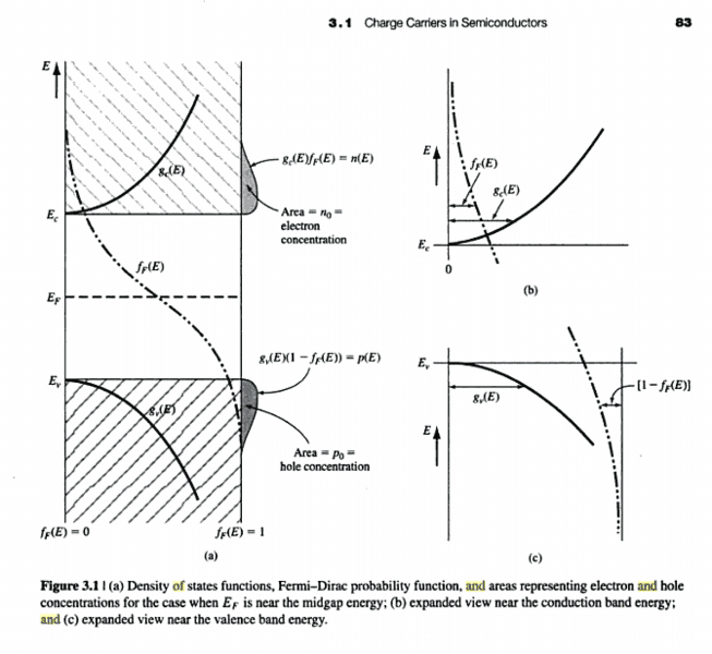

Hello. I was studying the Semiconductor and I am confused with this diagram.
I have attached the diagram. Please tell me briefly what does this diagram say. So that I could ask further. I have confusion with this diagram. I don't want to be specific so that you describe the whole diagram briefly and I will try to understand it.

fF(E) is the probability that a state is occupied, as determined by the Fermi distribution (left=0, right=1). It is close to 0 for states of high energy (top part of the plot) and close to 1 for states of low energy (bottom).
gc is the density of states in the conducting band with that specific energy - it is zero at Ec and increasing for higher energy.
To find the number of electrons with a specific energy, you multiply both functions, and get the shaded area. Its area is (proportional to) the total number of electrons.
gv is the same in the valence band.

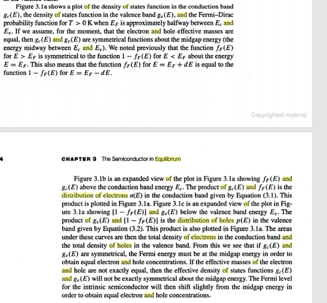

I am confused with a sentence "We note previously that the function f(E) for E>EF is symmetrical to ...", last four line of the first paragraph.
Would you please help me in understanding how f(E) for E=Ef+dE is equal to the function 1-f(E) for E=Ef-dE.

Close to the Fermi energy and for small temperatures (always true in semiconductors), the function is nearly point symmetric with f(EF)=1/2 as symmetry point.
That relation is just another way to express this symmetry.

I read your post several times and I got what you have said. Thank you. It is cleared now. I hope you will help me next time if I post another thread for help.
