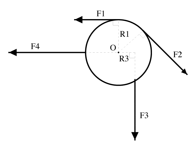

A uniform 2.9-kg cylinder can rotate about an axis through its center at O. The forces applied are: F1 = 2.4 N, F2 = 3.9 N, F3 = 6.1 N, and F4 = 4.6 N. Also, R1 = 11.2 cm and R3 = 4.0 cm. Find the magnitude and direction (+: counterclockwise; -: clockwise) of the angular acceleration of the cylinder. (see attachment)
I'm having a hard time with this one. I know that:
Torque (net) = Inertia * Angular Acceleration
and
Torque = Force * Radius
I've got:
T(F1)=0.2688 Nm
T(F2)=-0.4368 Nm
T(F3)=-0.0244 Nm
T(F4)=0 Nm
Tnet=-0.1924 Intertia=0.0181888
and the angular accerleration= -10.58 rad/s^2 (INCORRECT)
What am I doing wrong?

I can't see the figure yet so I can't tell. But the torque is F times r times sin theta. That may (or may not, depending on what direction the forces are acting) explain a discrepancy.

The diagram seems to show a single radius. What are R1 and R2? What's the radius of the cylinder?
OK.
and
Don't forget the angle that the force is applied.
Torque = Force * Radius * sin(angle)

All angles a 90deg, that would just be multiplying by 1, right? Also, is my F3 torque correct? I did .004 * 6.1

Your T(F3) is off by a factor of 10. That will probably do it.

Perhaps you are defining things differently, but only F1 and F2 are applied at 90 degrees to the radial line through the point of application.

UGH! That was it...I got it. Thanks!
