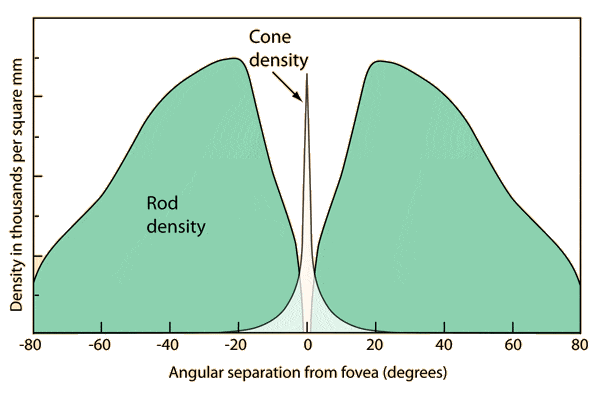

One thing I can tell you is that the human eye is not the same resolution across your visual field. Acuity is much better at the fovea than at the outer areas. It depends on how densly the neurons in the eye are packed. There is only so much room in there for various rods and cones. I'm not sure how the human eye compares to cameras in terms of resolution. I know that human vision an machine vison in general are very different things.
You might be interested in the following figure:
about rod and cone density on retina (rods are for aren't color sensitive, but are more sensitive than cones, who ARE color sensitive) on the following website: http://hyperphysics.phy-astr.gsu.edu/hbase/vision/rodcone.html
